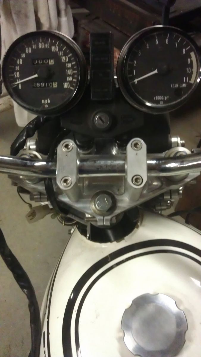

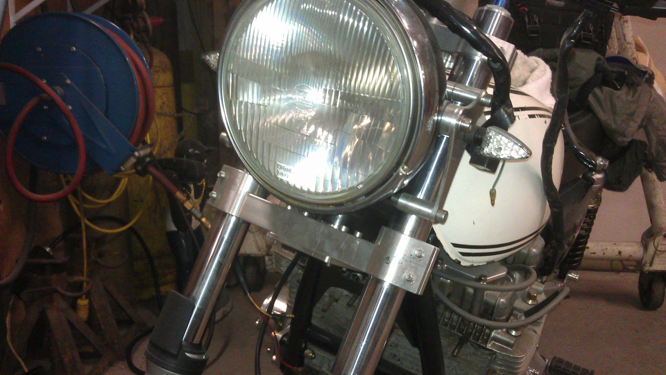

Good eye, yes that LTD did get a fork swap. I used a YZF600r fork because it is very long at 31.75 in., it is mafe with a 17mm axle, Race-Tech makes all the tunning parts needed to set them up and they are cheep & easy to find. I made the triple clamps and guage mounts.
