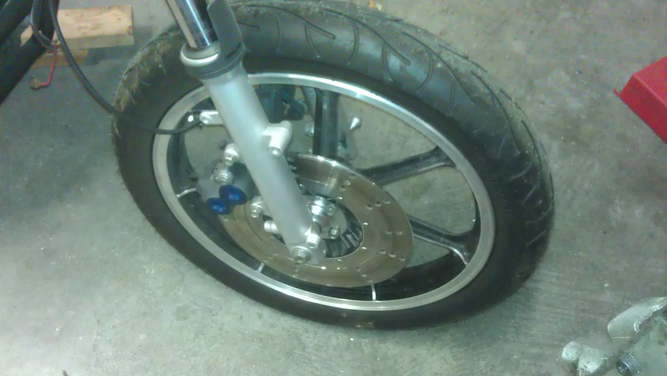

Yes, it can be done. I have a pair of R1 monoblock calipers that I am using with the stock front wheel and discs on my 1980 B4 project.
If you are lucky your calipers will clear the spokes when centered on the discs. If not, you will have to move the discs away from the spokes with a spacer. You are limited in this by the fork leg location and the size of the half of the caliper that lives between the spokes and the disc. Some modern calipers are smaller then others.
Then you will need to make a mount that holds the caliper in position, centered on the disc.
You will also need to use the correct mastercylinder. The R1 calipers I use need a 14mm Nissin inline master or a 19mm Nissin radial master.
I have used solid mount discs with solid mount multi piston calipers for years with no problems.

Wow a triple, I've never done that before! I will try to take the extras down so please forgive me.

Also, did you do a fork swap to the bike, keeping the wheel or are they KZ forks? The angle you took the picture looks like the caliper bolted right in.
