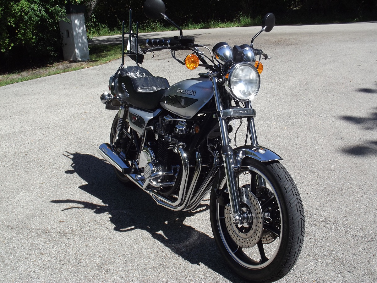

Pete, that KZ looks in great condition, I would like to restore mine someday.

Thanks kzb4, I've sunk a lot of money into it over the last 30 yr's which I know I'll never see, but all the complements I get every where I go, makes it worth it to me
