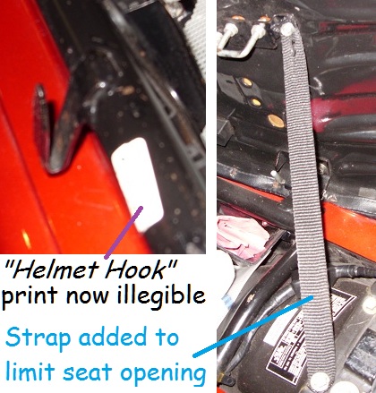

"Perfect length" nylon strap.
Quick, simple, effective, non-destructive, easily removable.
Using a hot pointed tool to punch the holes produces firm, crystallized, non-raveling holes.
Good Fortune! :)

Patton,
I just had one of those "Ah Ha" moments.
Thanks
