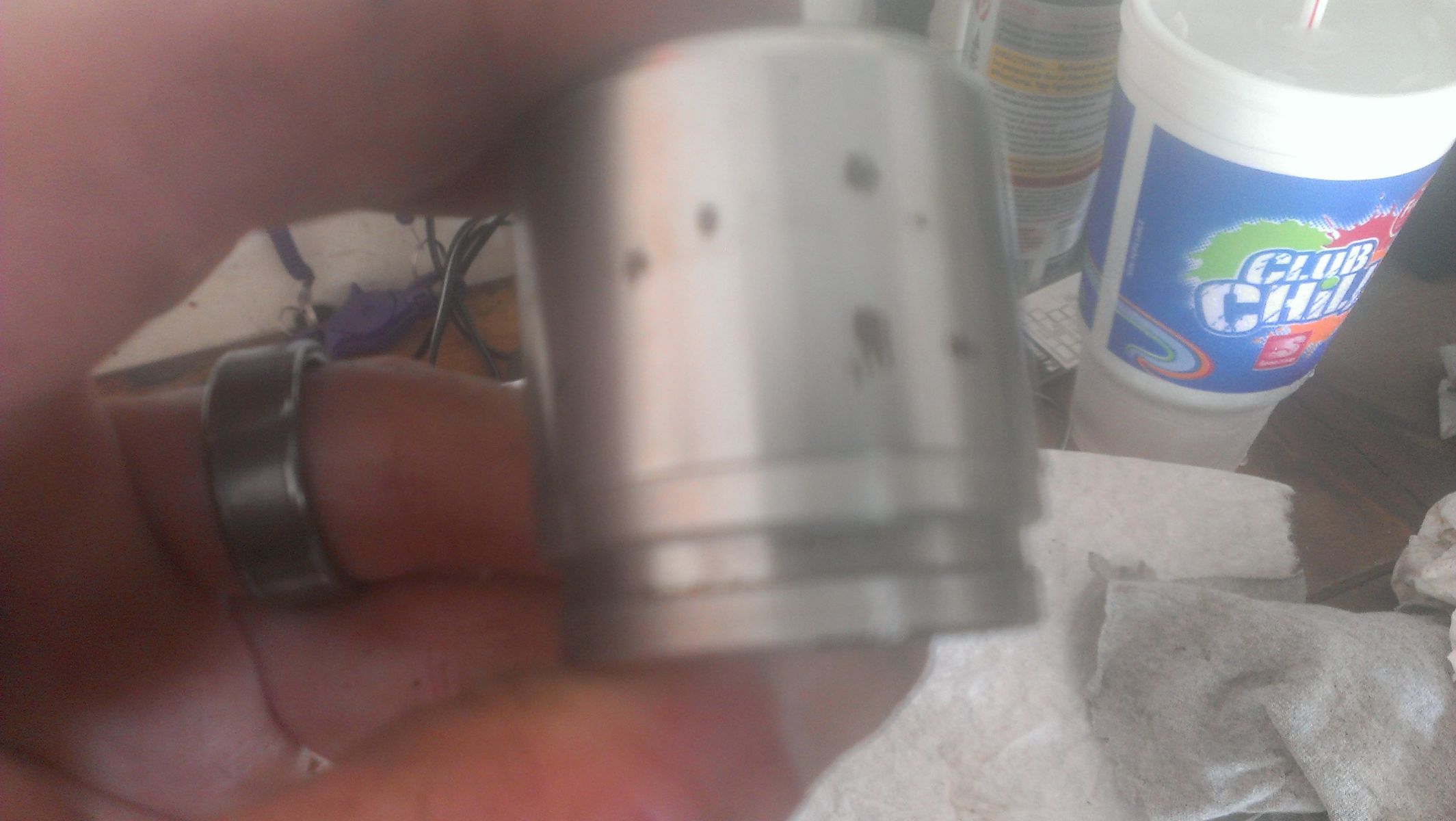

is this piston ok?

is this piston ok?
08 Aug 2013 14:54
#600431
Front caliper. Has some rust pitting. Should I get a new one?

Re: is this piston ok?
08 Aug 2013 15:06
#600432
as long as it doesn't leak it should be ok but is it worth the risk on brakes?
08 Aug 2013 15:06
#600433
Hard to tell from the pic just how deep those pits are. I've had some pretty rough pistons from my Honda that I was able to clean up on a wire wheel and they are working ok. You can try to clean up with a green or white scotch brite and see how it feels. If you can catch your fingernail on it pretty good then you may want to replace. Bummer, cuz I know they are pricey.
08 Aug 2013 16:23
#600450
What's condition of the bore? If badly pitted, may tip the scales in favor of replacing the caliper.
08 Aug 2013 18:37
#600468
The caliper bore is as smooth as a baby's butt. Took some 1000 grit sandpaper to it. Ordered a new piston and o-rings for it. As well as new bleeders. Then surely I can get this thing bled before moto go next weekend.
08 Aug 2013 21:30
#600495
You did right getting a new piston. This is the sealing surface for the seals. Also the Groove where the square O-ring sits. Bore for the piston is less important. As long as the piston fits well, not sticking or excessively loose. A few small pits in the bore would just hold fluid, it would not cause a loss of sealing.
