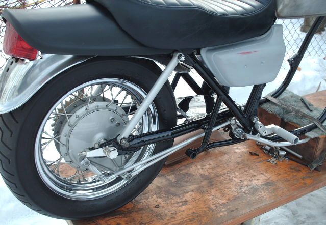

I run a 150 70 18 on a stock setup. There is about 1/4 or less using a 630 chain. Chain doesn't hit ever tire and fits perfect.
