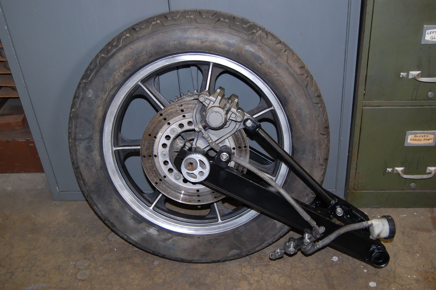

I have one on my 650 with a GPZ mono swing arm. Just cut down a couple of spacers.

I did the same as Mark (except my swingarm was a 85' 750). I fit it by swapping the eccentrics
with those off a ZX900 (turned down to fit). I now have a JMC swingarm which should be no problem.
