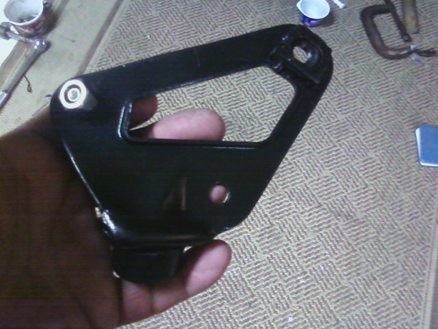

We decided to go with a Vance and Hinze 4 into 1 because the original system was rotted out .
but now I can't figure out how to stop the center stand from hitting the chain.
We have this part that came off the bike and I'm sure it attached to a muffler but I can't figure out where it goes.
Kawasaki.com is only giving me a parts list now for some reason and no diagram :huh:
We want to keep the center stand so any solutions or pics would be appreciated.

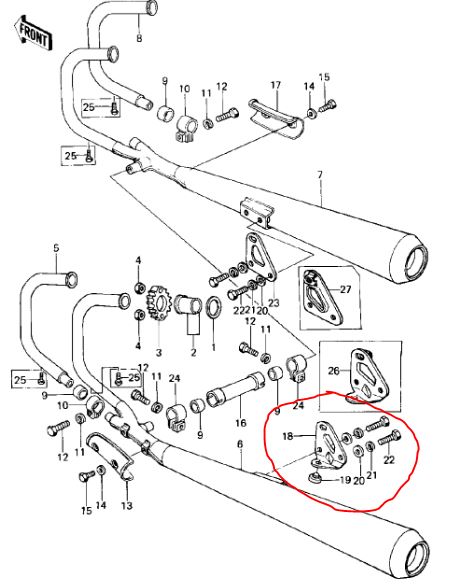

Try the diagrams at Parzilla. It's probably supposed to attach to a muffler/footpeg stay that's welded to the frame. It could be that someone cut it off?

Thanks Martin, I found it on Bike Bandit and I'm hoping to make it work temporarily until I can fabricate something.

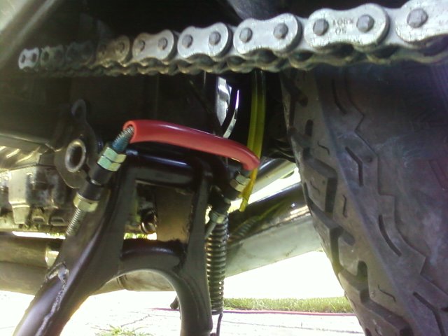

Well it just so happened that I had some 5/16" threaded rod laying around and was able to bend up a decent stop on the first try, I think the pink fuel siphon hose adds a nice touch
Please notice the spring in the back ground it is the original spring off 650ed's bike and it looks prefect , thanks for the MoJo Ed I hope I can meet up with you and your bike in person someday and buy you lunch
JD
