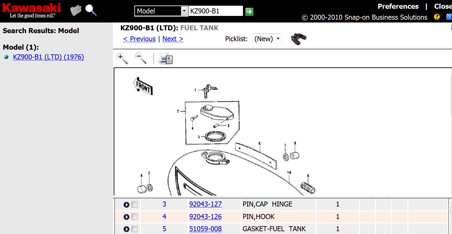

Cap Hinge Pin Part # 92043-127 is shown as an "Active" part available through Kawasaki dealerships.
Lots of good info on kawasaki.com, including parts diagrams, part names, part numbers, models sharing same part, availability, etc. Here's a link for help with navigating the site and finding information.

It is a roll pin that holds it on, this would be a good time to replace the rubber gasket on the gas cap.
