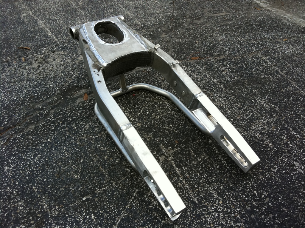

99-07 busas need custom pivot bolt reducer bushings machined out to make them a bolt in.
i would remove the upper brace and weld an under brace on,add the dual shock brackets and it is a bolt in deal after the custom work that accepts a 99-07 busa rear wheel brake etc...
here is one done.
here is one done.
