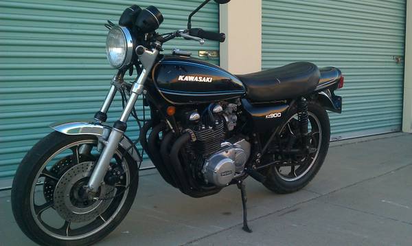

this pic shows the type of disks i bought and my worry about mag/spoke offset diffs...sounds like it will work
all that said i got everything to do it but just in case...i want a running bike for GP week and bike night...

sweet thanks..yes my u.s kz900 A4 has a thick ass disc...the duals i scored have thinner and look just like that picture i found and posted of the drilled dual disk 900

19 Aug 2013 19:26Those look like z1r wheels/brakes in that picture.trianglelaguna wrote: gosh that would be cool thanks guys...i am not going to take the front end off till after MotoGP ...which is right around the corner...but then the forks down to race tech the swingarm down to a member here for some bracing ,,,, spiegler brake lines and dual disk and calipers...
