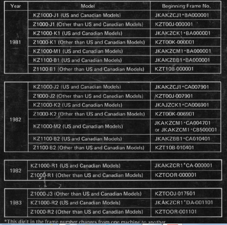

What year are these for? Don't want to download what I don't need. I have a Z1 and a76 KZ book but would like something for 77-78. Thanks

From KZr FILEBASE, Z1-KZ900 manual:
www.kzrider.com/filebase/doc_download/43...asaki-service-manual
81-83 KZ1000/1100 manual:
www.kawiworld.com/index.php?option=com_c...icle&id=77&Itemid=99
