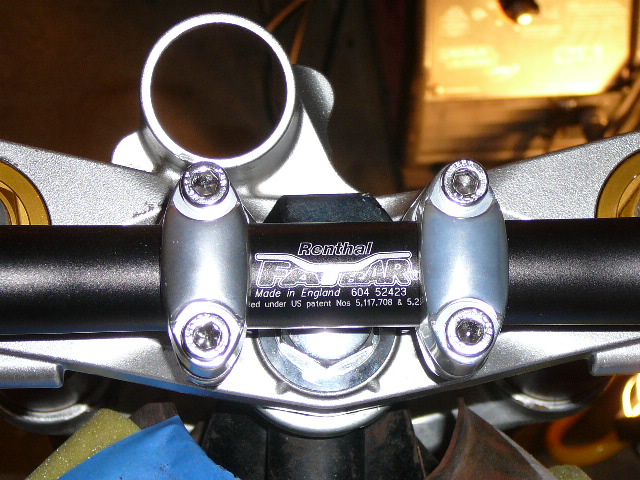

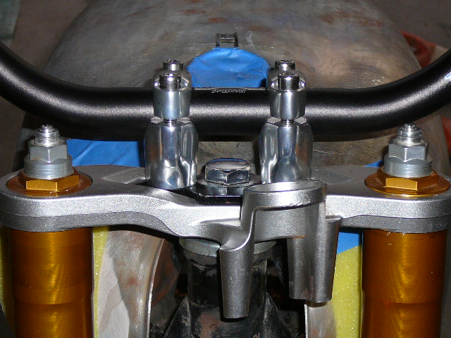

I have used
these
on three of my builds. Sometimes the mount bolts are a bit long but nothing a hacksaw or cut-off wheel can't fix.
Here are the risers on my Gsxr project..
Later, Doug
Later, Doug

They're not super high but if you have access to a machine shop with a mill then you can always machine them down and shorten the bolt a bit more.
Later, Doug
