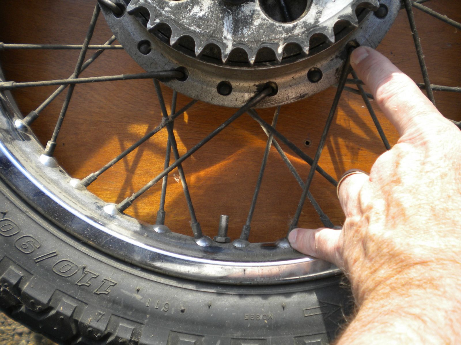

I jumped the Gun on wheel building and need help.
- Pop147
- Posts: 45
12 Jun 2013 21:45

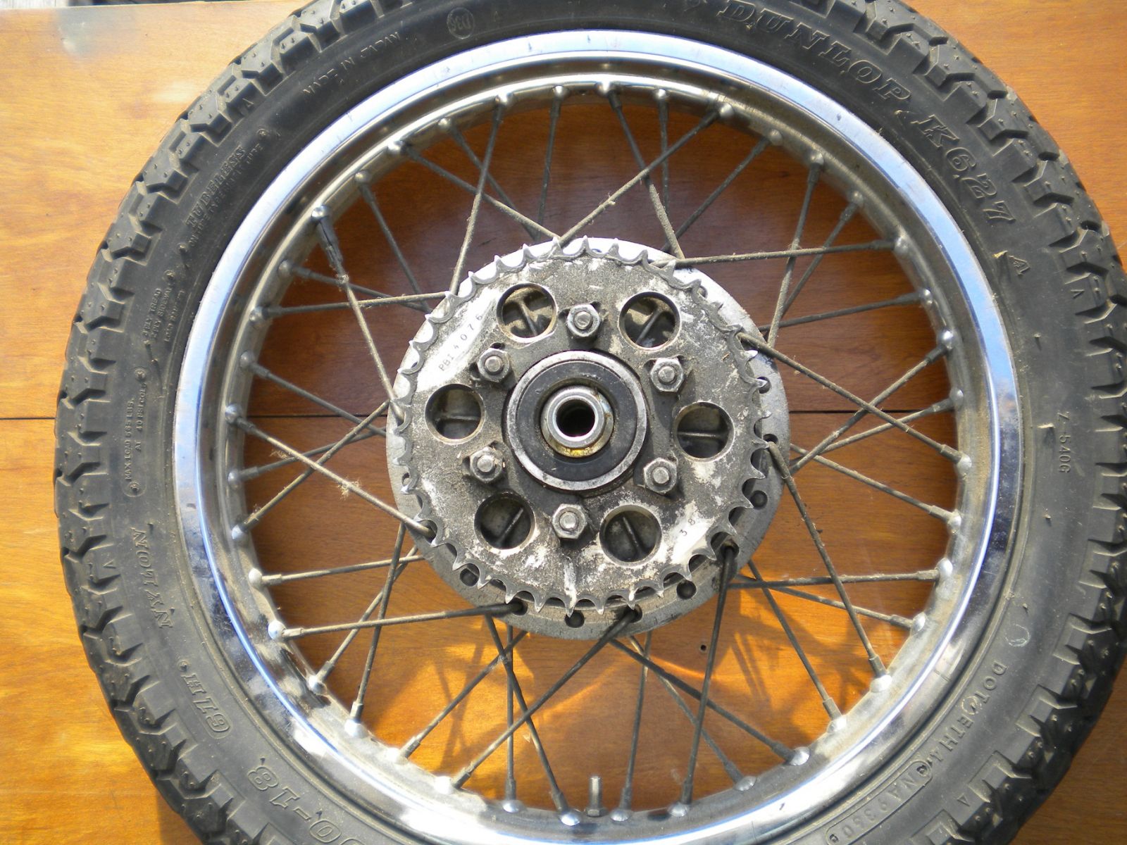

Can anyone tell me what the stock dish is for the rear wheel on a Kz750 b4 and what the equivalent oem part is for these buchanan spokes are. Any info on building wheels will be appreciated too i dove head first in the this project and got a little ahead of myself the wheels are already apart so i can't figure anything out.

Re: I jumped the Gun on wheel building and need help.
13 Jun 2013 14:55

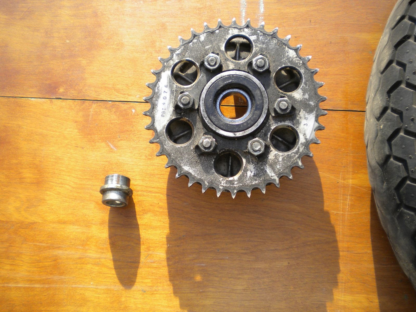

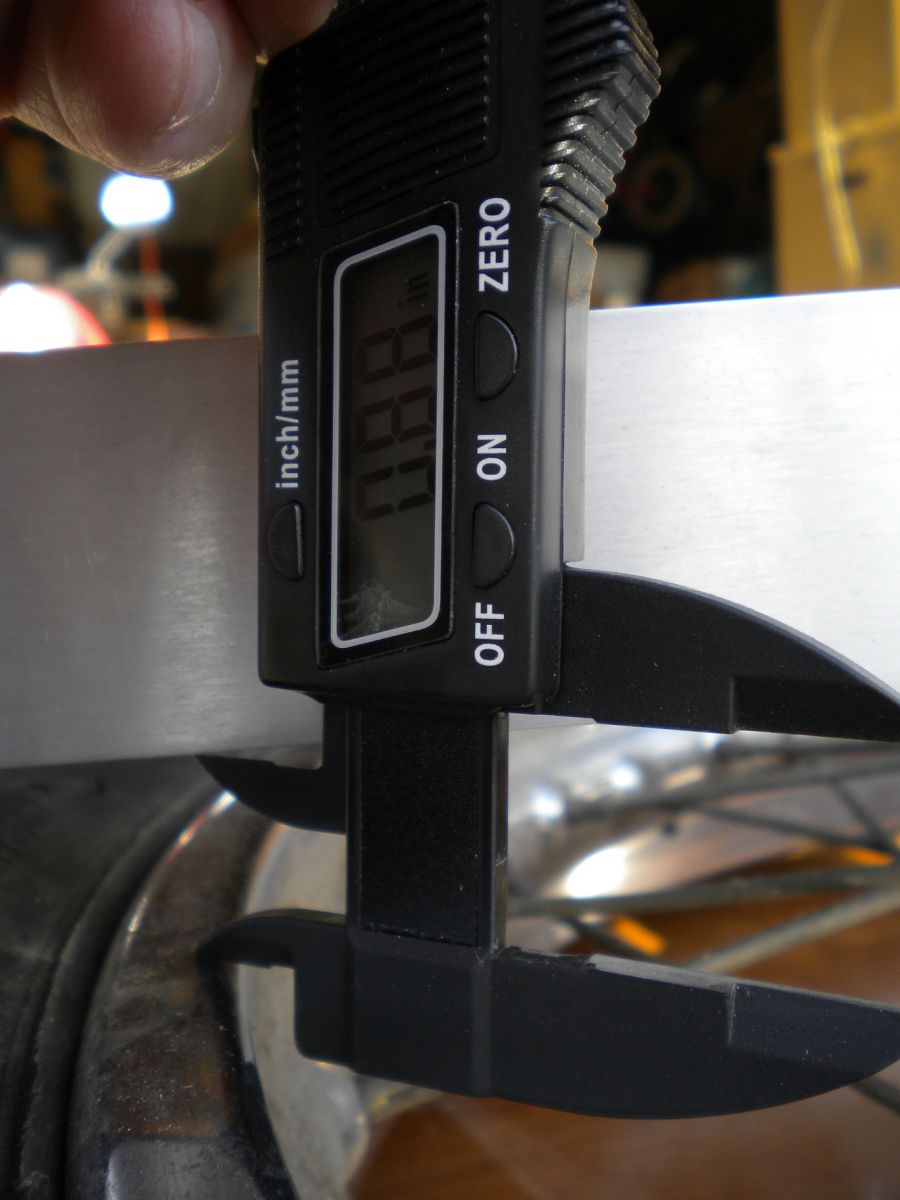

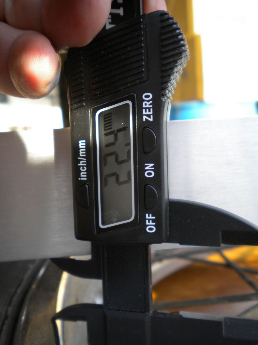

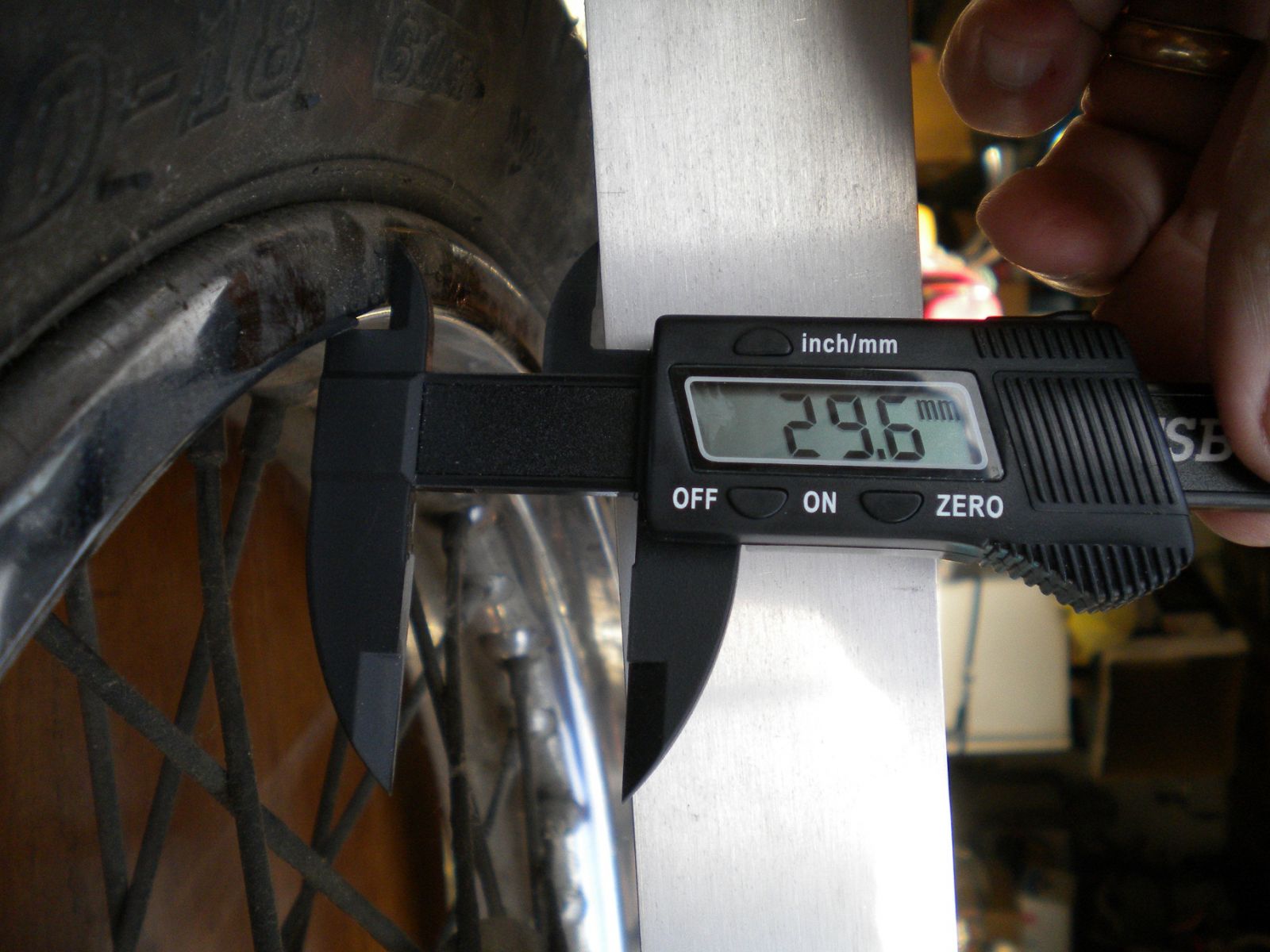

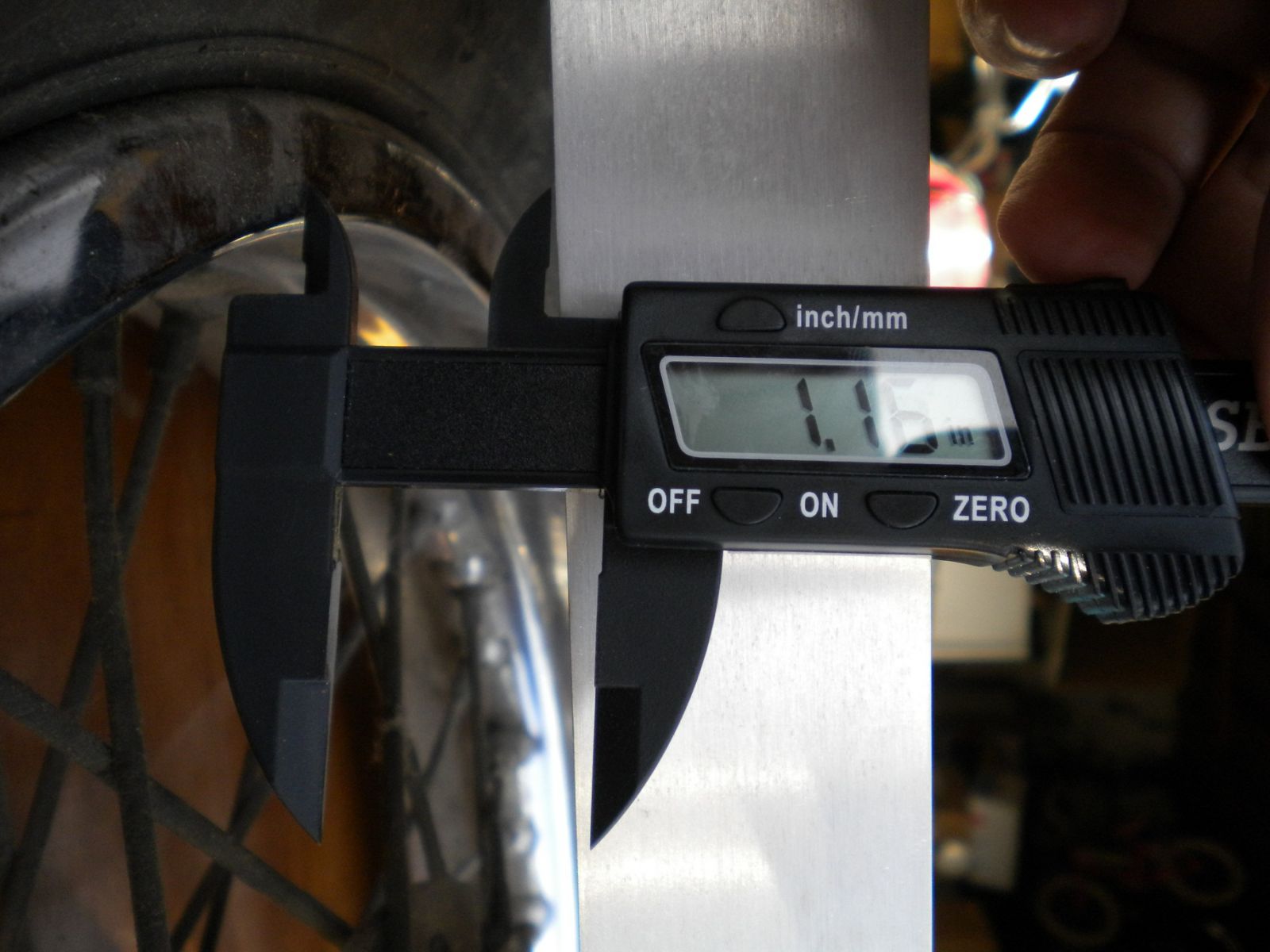

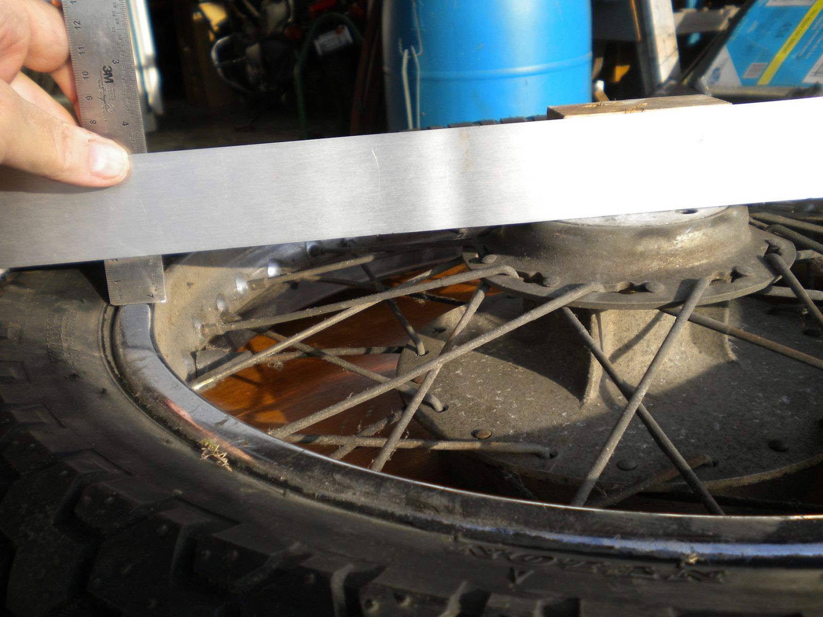

Pop147, I have a spare stock 79 750twin rear wheel un-mounted and can get you pictures and any dimensions you need tonight.
I will post pictures and dimensions here.
14 Jun 2013 15:02

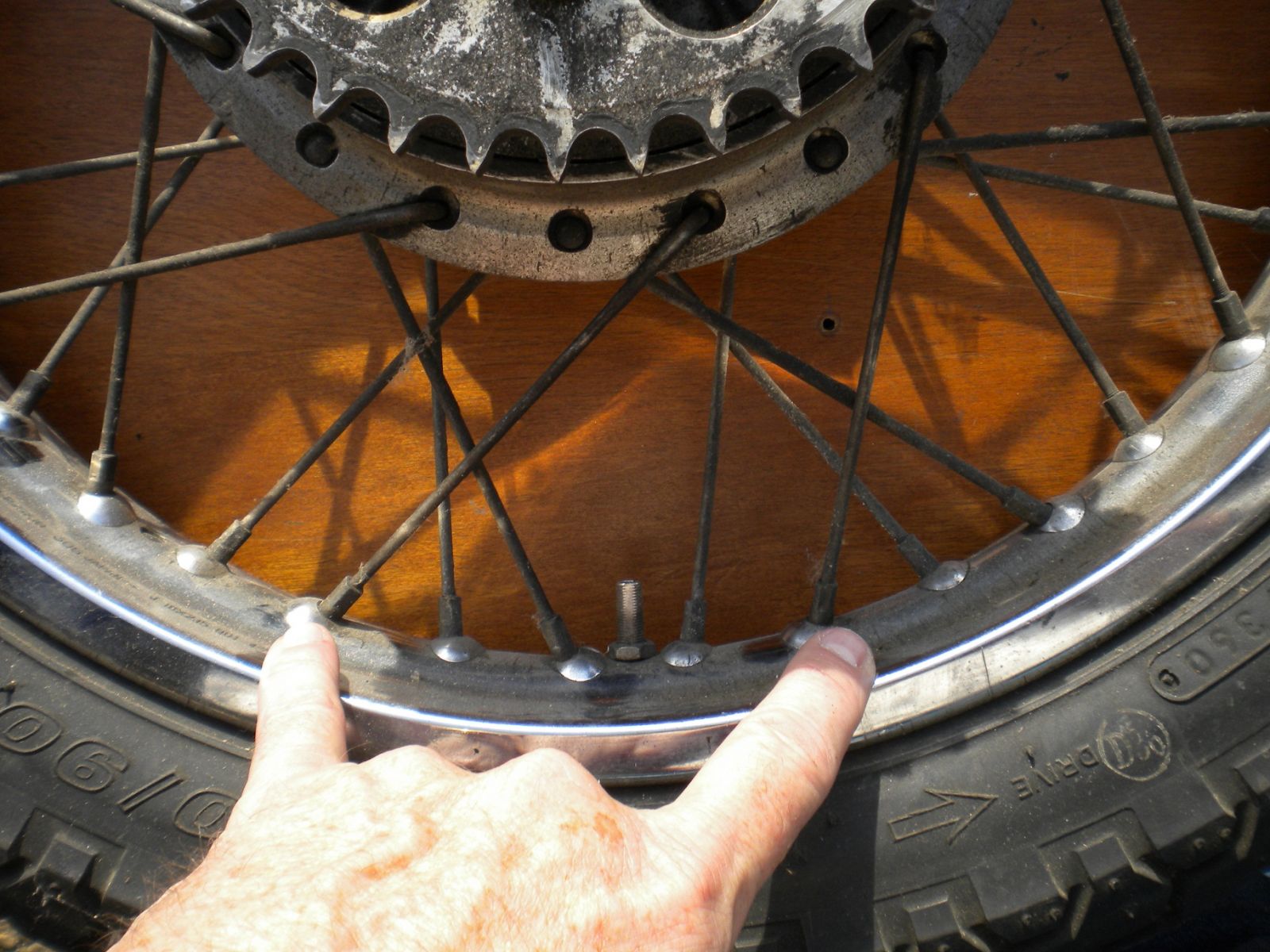

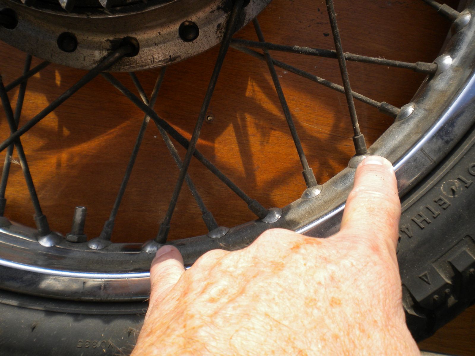

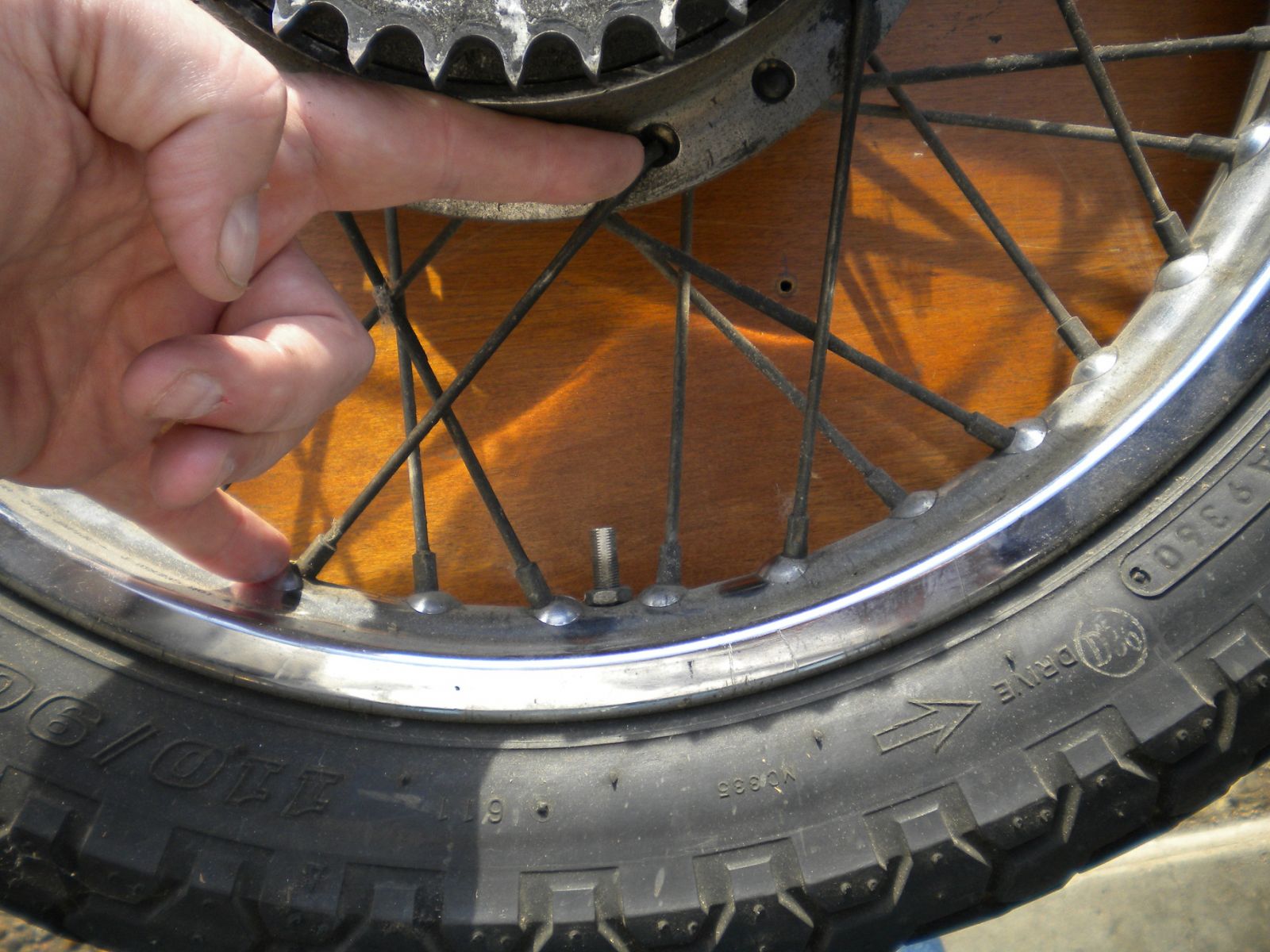

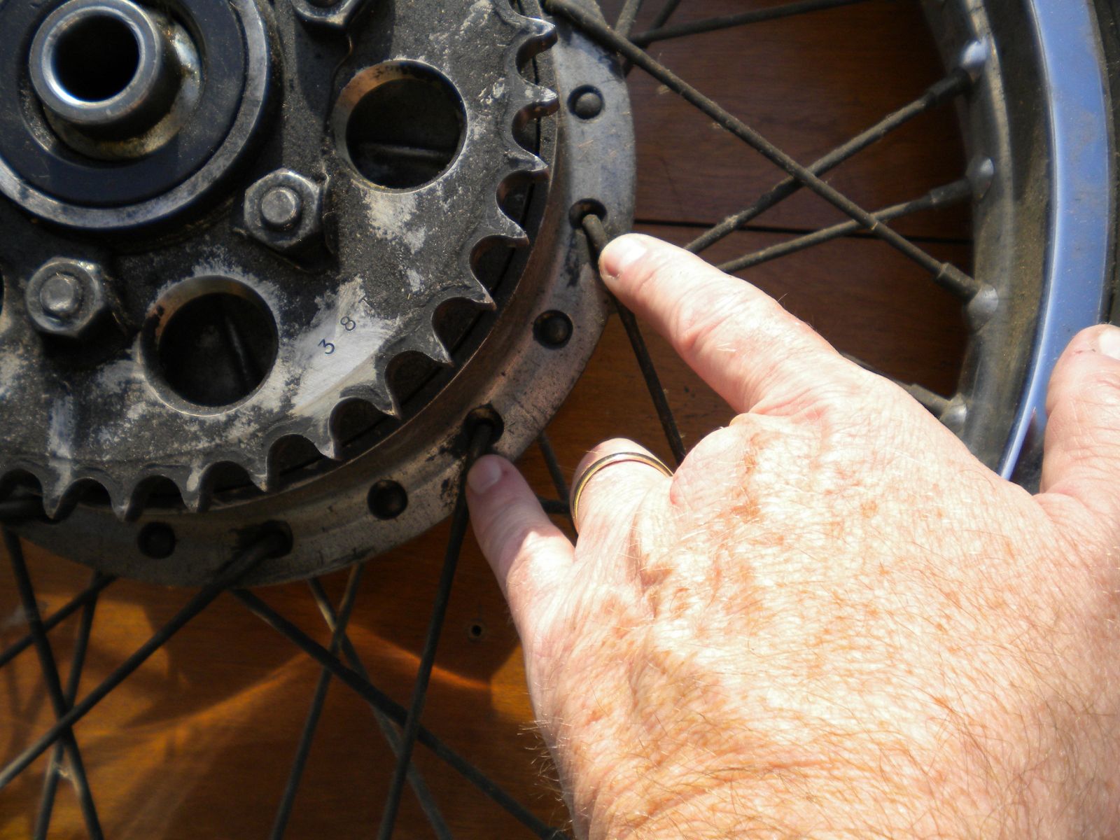

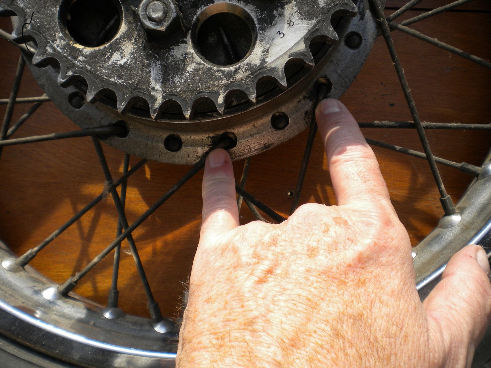

When re-lacing, start on the sprocket side at the tube nipple hole (not one of the rim clamp holes that are across frome each other).
The spokes repeat 2 holes on the hub, 4 holes on the rim
Short spokes on the sprocket side, long on the brake disk side.
