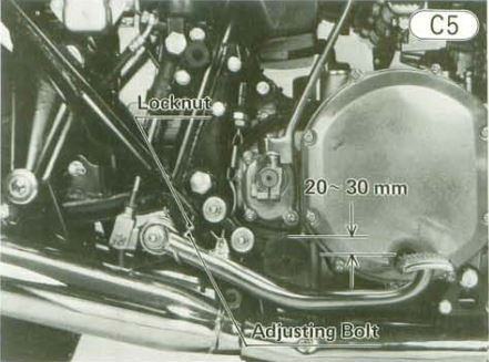

Check the adjustment bolt and make sure that the lock nut hasn't come loose and the bolt has spun down holding the brake pedal from coming back up and allowing the fluid to return to the reservoir.
Note; this is a picture of a 78 kz1000 but I would guess that your 76 kz750 should look similar.
I had a mechanic rebuild the master cylinder and caliper years ago trying to fix my stuck brake.
After the third time in there the owner of the place came over and had a look.
He started at the brake pedal then he looked at the bolt :pinch: problem solved.
That's one of the reasons I do my own work now, because I can't afford to pay someone else to screw up my stuff for me.
78 KZ1000 A2A

Can you take a close up pic of the side with the brake pedal .
