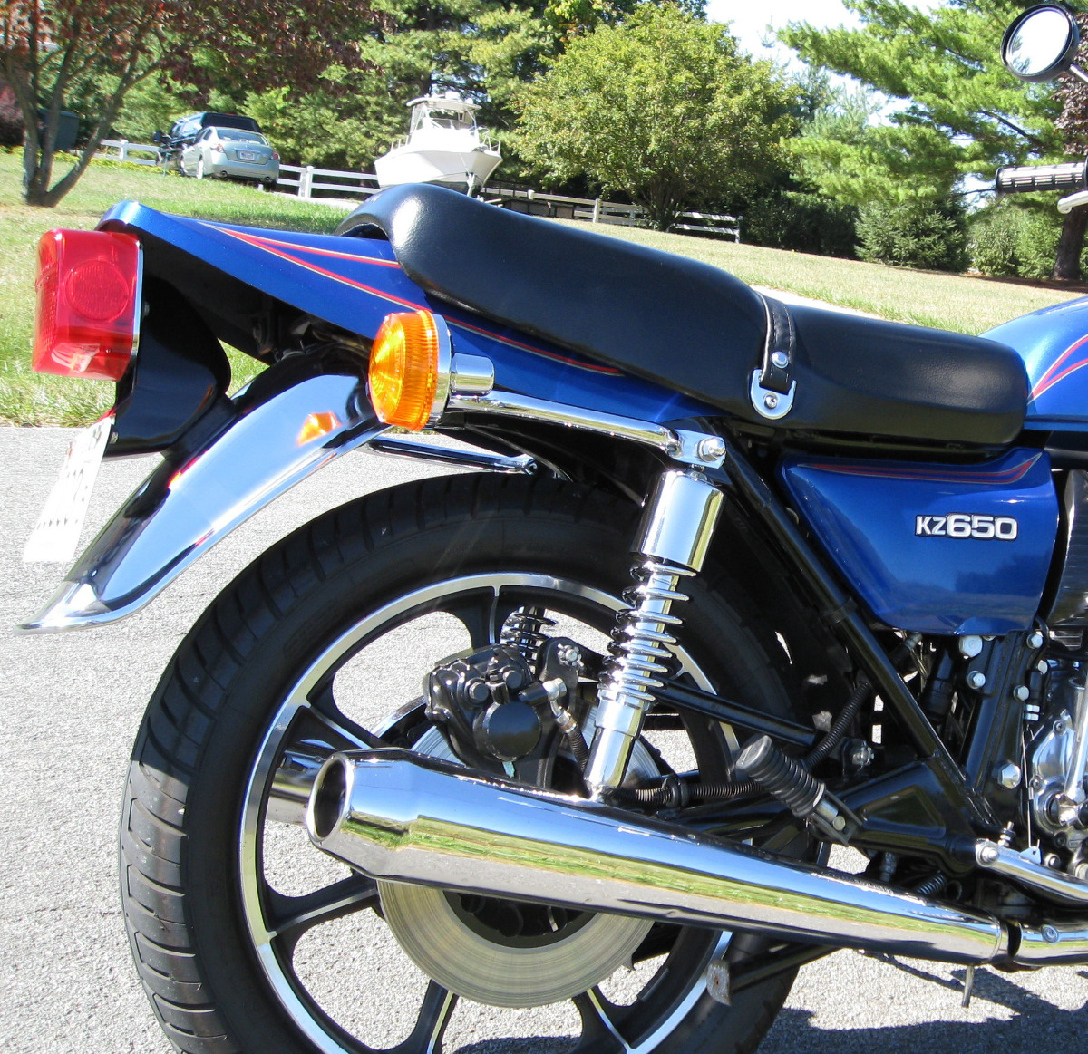

If your bike still has the original shocks they have been shot for at least 28 years. The original shocks were arguably the weakest component on any KZ. I have been using Hagons for years and they work great! If you contact Dave Quinn at the link below he will set up a pair to match you bike, your weight, your riding style, etc. Mine are like #4 in the bottom picture in the link.
davequinnmotorcycles.com/cgi-bin/webc.cg...GON_TWIN_SHOCKS.html
Here's a picture of mine:
