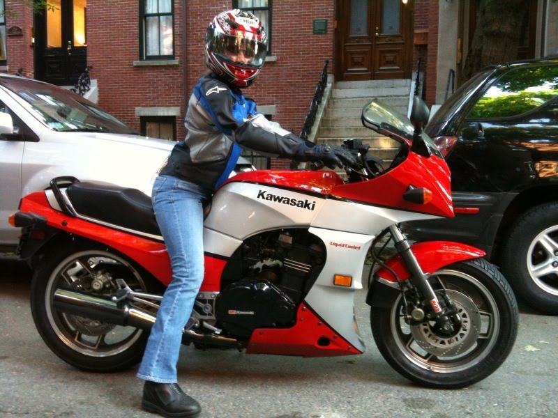

ninja (EX 500)500 swingarm picture

that was my first guess....ninja 900 ...84-85-86 yr

Bingo! Thanks, guys. After I get this little street fighter in action, I am starting a factory style resto on a 75 Z1B that my family has had around since 78 and in storage since 1981. I look forward to some time on this site.
