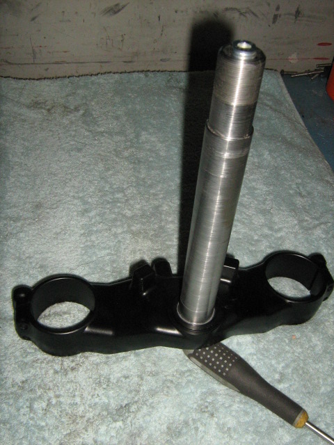

This is the new stem: (made to fit the origianl nut)
Found this nut that fit 25 mm Suzukis...but does it fit the KZ1100 stem ?

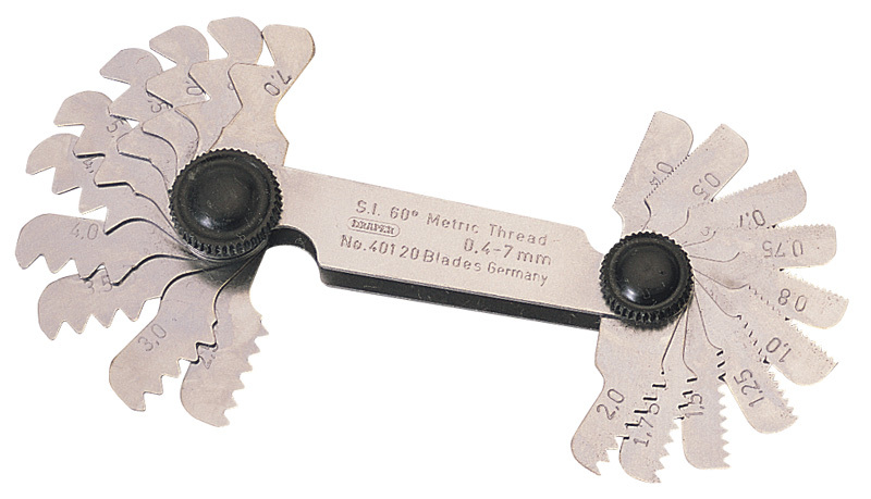

Thread pitch gauges are inexpensive and readily available.
Handy tool drawer item.
$7 at Sears
Click here > www.sears.com/craftsman-screw-pitch-gauge-metric/p-00952316000P

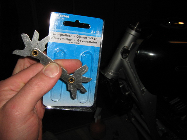

Patton: Thanx...found a gauge at Swedish "Biltema" for $6.5 !

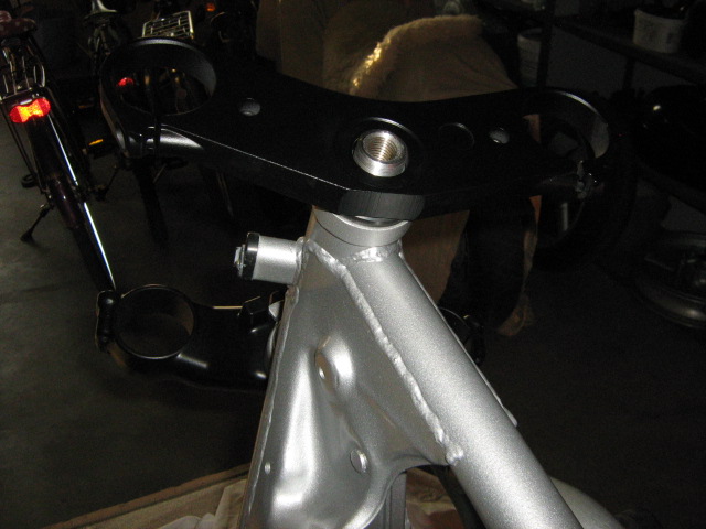

Haybus: I´m converting to Yamaha R1 triples and kept the stem from KZ1100. The top nut will be visable for above. Check out my thread for more pics..see my tag line for link.

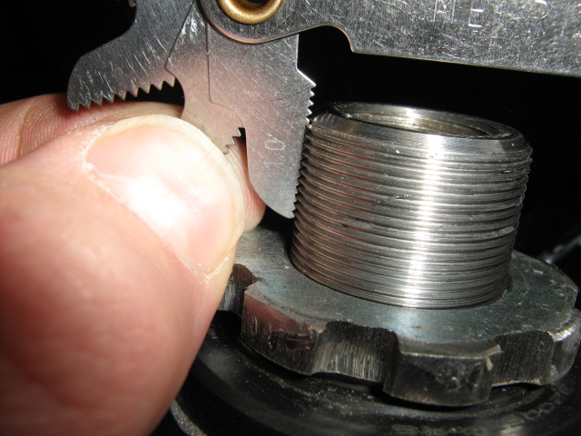

Steell: You were right the pitch was 1.0 mm
The gauge:
Measure:

For the record:
KZ 1100 -82 Steering stem thread is:
25 mm x 1.0 mm
