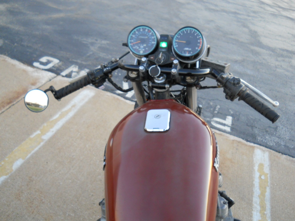

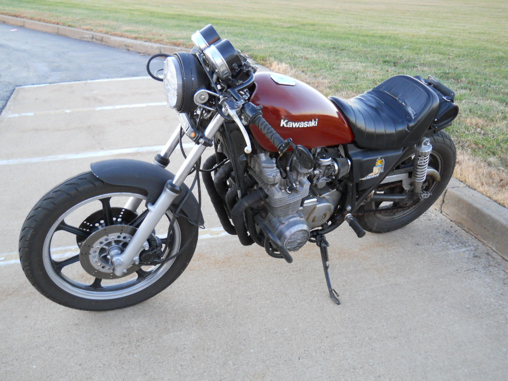

clubmans on a 80 KZ750H1 (4 cyl LTD)
The LTD brake reservoir is a good fit with the clubman bars. Slngle disc reservoirs can be found on LTD versions of the 440 twin, 550-4 and later model 750 twin.
The stock cables and brake hose was used with some creative routing. The LTD cables are longer than the cables on a 750 twin so they should work.
Good luck,
Jim

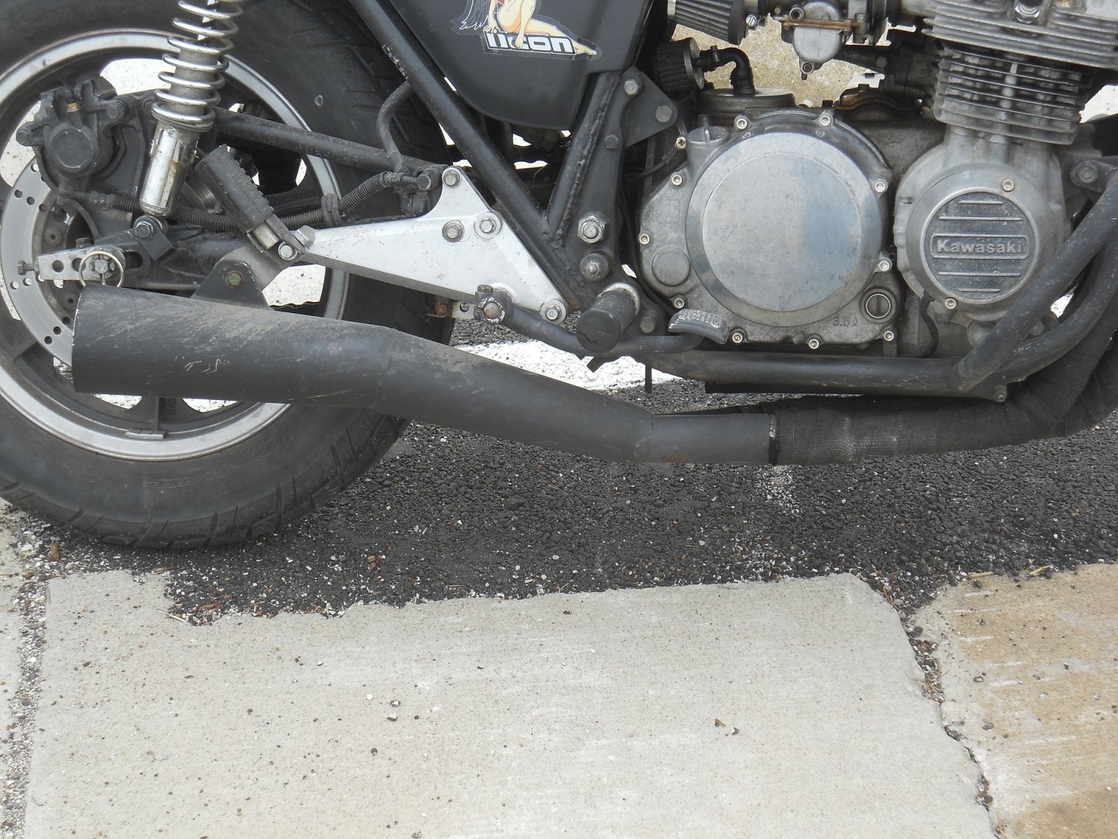

Foot pegs, standard footpegs removed along with the lower foot peg post (nut on backside).
Replaced with rear pegs from a 750twin screwed in with spacers to keep from bottoming on the end of thread. Brake and shift levers shortened to suit.

Bad ass bike!!
I will definitely buy my own clubmans bar as well!
I want that look on my bike even though it might hurt a bite i the wrist/shoulder after some time.
No pain - No gain
I will post a pic during the summer with the new look.
