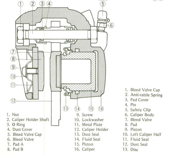

I don't know how your caliper is set up but on a 78 kz1000 this is what it looks like
I rebuilt just about everything on my chassis last year except the front caliper and it gave me a little trouble for a while shuttering kind of like what you are talking about when I used the front brake .
My fork seals,brake pads and wheel bearings have been replaced so all that is left to change is the old rubber brake parts, inexpensive stuff.
# 3 - O rings (4)
# 4 - dust covers (4)
# 13 - dust seal (1)
# 14 - fluid seal (1)
The problem went away but I am sure it was related to these parts being original and they need to be replaced, parts ordered.
