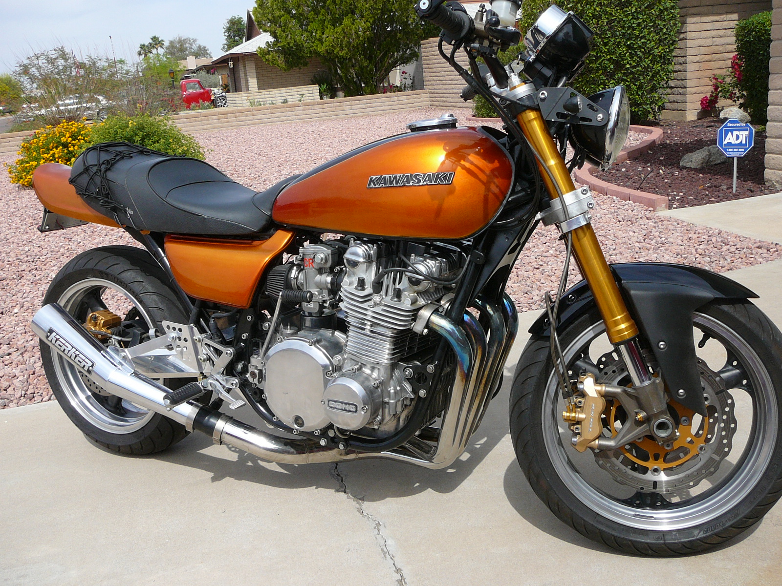

Same tank, mod the tank mounting (rubber damper studs above coils, cut and re-welded into place), seat mounting hinges and tail piece back ~ 1.5"....
They make clip on risers... Google is your friend....

I just checked yours out, you used a different style suspension. Looks very good. Did you also have the same problem with the forks hitting the tank? My forks being inverted also are huge up top. I thought about cutting into the tank, but I think that would take away the look of the tank that everyoneknows.
I will try tonight to push it back and see how it looks. Maybe if I had somekind of dash or something there in front of the fuel cap to cover up the gap...

All of us modding the fron ends had this issue for newer forks widths, in my case Kawi ZX6R, are ~ 10" wide outer tube to outer tube....
Some chose to leave it (powder coated frame :pinch:) as is using redesigned steering stops and just don't turn full radius.... :blink:
@ 1.5" back I don't have a huge gap that looks awkward... to me anyways... Can't say for your set up....
