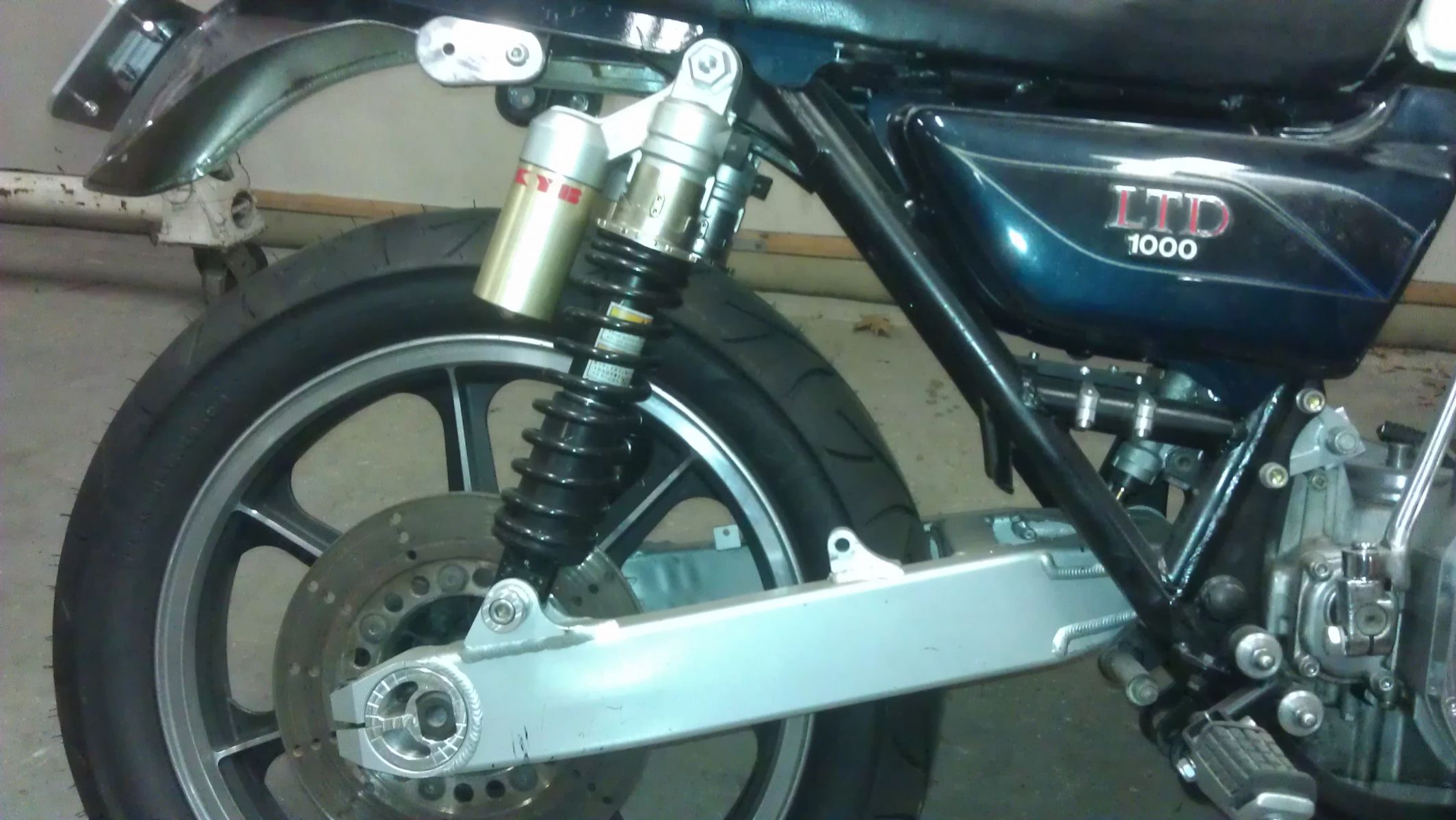

Here is what I ended up with.

That gear shift linkage looks a little tortured....can you get the linkage rod to connect to the inside of the "L" bracket coming off the gear selector shaft? Just to get it more in line?

Maybe, but it does work well.

13 Oct 2013 20:28bluezbike wrote: That gear shift linkage looks a little tortured....can you get the linkage rod to connect to the inside of the "L" bracket coming off the gear selector shaft? Just to get it more in line?
Just my 2 cents
I fixed it! Cut it loose,shortened up the mount and rewelded. Could have maybe moved it a tad more in but this is close.
