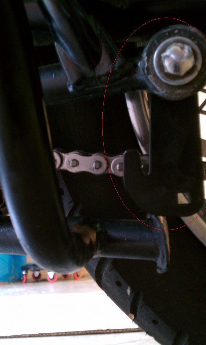

A bit embarassing explaining what this is, but here is a picture of what I used for my used Kerker. Something similair may work on your bike. I just mounted it on the left side muffler mount point. Its a anchor attachment that came with my flat screen TV wall mount, LOL. They give you different styles for differnt types of mounts that vary from brand to brand. This one of the pairs that was not for my TV. I make it a point to save everything. Kept thinking what I can use, and had an hour left before a going for a group ride that day. Was supposed to be temporary, but looks good and works perfect. Didn't have to paint or anything. Just had to enlarge the hole for the mounting bolt. Maybe you can fabricate something from similiar.

I had same issue. Did the search and found this post.Installed a Mac 4-1. Bike is not yet running. Tonight I was looking at it and discovered the chain contacting the centerstand. It took me a minute to figure it out. I used one of the brackets that came with the exhaust and made a stop, very much like the one posted above. It will work until I can come up with something better. It did give me something to hide the exhaust hanger hole with though.
