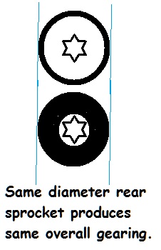

Re: LTD 1000 rear tire height
07 Mar 2013 01:07
#575747
Scootjockey wrote: Does anyone know what the rear tire height is on the LTD 1000? I'm doing a swingarm/wheel conversion, and I need to figure out what size sprockets I need to be close to the same gearing. My original rear wheel and tire are long gone. Thanks.
Am thinking overall tire diameter of rear tire is about the same on LTD and standard model, as is axle height.
May find various tire-related measurements on Dunlop's site, including overall tire diameter, applicable rim widths, etc.
www.dunlopmotorcycle.com/
Good Fortune! :)
