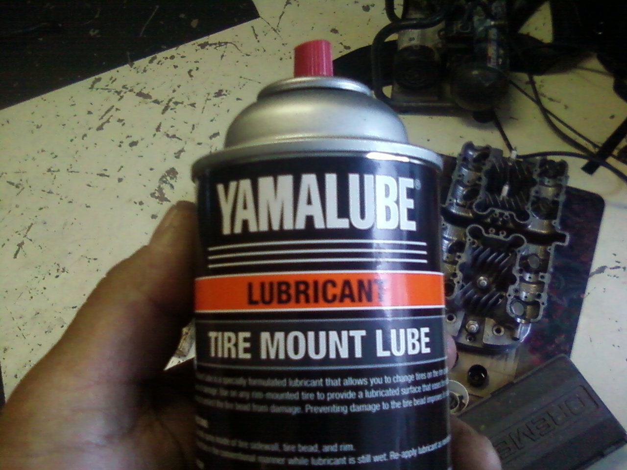

25 Apr 2015 08:35bluej58 wrote: I got rid of mine.
JD
Now I'm putting them back on :whistle:
After running somewhere around 25,000 miles on Pirelli and then Avons with no problems at all I finally had my new Avon roadrider(rear tire) slip and blow out doing around 45 mph :pinch:
I knew what was happening and was able to slow her down with no problem, thankfully I am still breaking in the new rings or I would have been on the highway doing 85 instead of the frontage road, lucky break.
The really stupid thing is this was the second time it happened :dry: last week I had one blow out and assumed it was a faulty inner tube.
The last set of tires I used soapy water to install them but I didn't like the rust I found when I took them off to replace them so I decided to give this stuff a try and it worked real good, too good!
Now I have to figure out how to get these damn wheel locks back in, this sucks.
Any tips will be appreciated but I will probably have them on and report back before long.
JD
