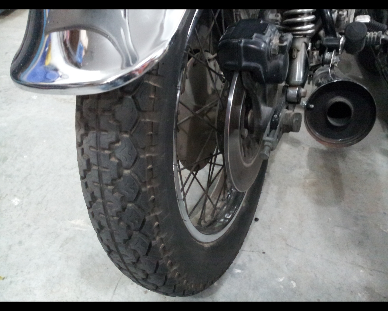

My 79 B-4 has a too powerful rear disk brake. It's just not well matched to the bike. When practicing panic stops, it's virtually impossible to avoid skidding the rear tire.
The bike has a 5/8" rear master cylinder already so I can't reduce the hydraulic force by enlarging the diameter of the master cylinder.
I suppose that I could machine the disk but then I'd have to rework the caliper and mount.
Does any one have an idea how I might reduce the power of the rear brake?
TIA
Bill

What tires are you using? Is it possible the compound is not sticky enough to give good traction? The Dunlops on my old BSA would have the rear wheel skidding if you even looked at the brake pedal. Ed

You need to pull the pads off and check what type you have. Sounds like you have Semi-Sintered (GG) or even Sintered (HH) metallic pads installed. The "GG" or "HH" will be stamped on the backing plate. I run HH pads on the rear of my drag bike because of the slider clutch. I have to overcome the decelerating engine force and the weight of the bike until the slider drops to a low RPM and drops out. I run a "slick" on front and never grab the front brake in the shutdown area to avoid the front end washing out on me. HH pads work great in my case and I can still lock up the rear if I want. I wouldn't want them on the back of my street LTD. If this is your problem, replace with a set of "organic" or factory pads. The rear will still lock up on demand but won't be as touchy. Don't try to modify any brake parts. Hope this helps.

Ed, How did you know I had a DunFlops fitted. I chose them for traction on the dirt. Perhaps more rubber on the road is what I need.

I've used several tire brands and models including 3 different flavors of Dunlops on my KZ650. As far as traction is concerned the Dunlops were the worst of all I tried, so your symptoms sounded somewhat familiar. Of course, that's on the street; they may work better off-road. Ed

16 Feb 2013 01:15650ed wrote: What tires are you using? Is it possible the compound is not sticky enough to give good traction? The Dunlops on my old BSA would have the rear wheel skidding if you even looked at the brake pedal. Ed
Pretty sure you're onto something there Ed.
