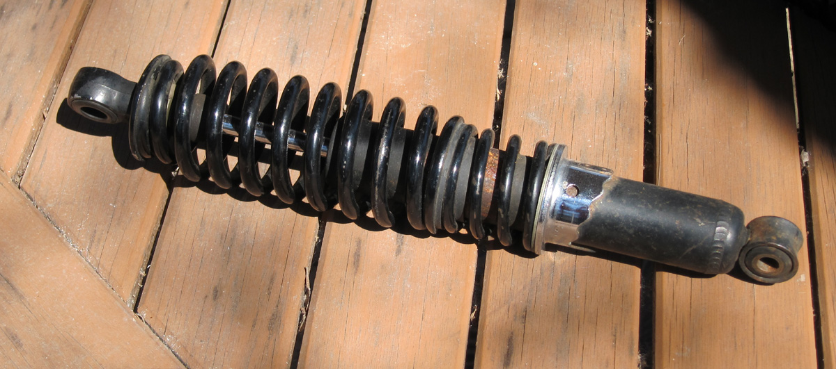

[attachment:1]C:\fakepath\78.jpg[/attachment]

Well now the picture works!

All the examples on ebay do not have this change, this reduction in the gap between the adjacent coils, at the bottom -- the examples on ebay have gaps between successive coils that are the same the entire length of the shock spring, -or- the change in the gap is on top not bottom, maybe that's why the part number for the 1978 Z1r shocks is unique to that model.
Because otherwise there are several examples on ebay that otherwise look the same - black spring, no cap on top, black bottom, and chrome preload adjuster 'ladder.'

if you look at wireman's excellent photo there, the shock spring coils tighten up at the bottom... ....maybe that's why the part number for the 1978 Z1r shocks is unique to that model.
I believe you are correct. The '78 Z1R shocks are the only model I have seen that used two separate stacked springs to give a progressing rate. I think even the '80 Z1R used a single spring.
