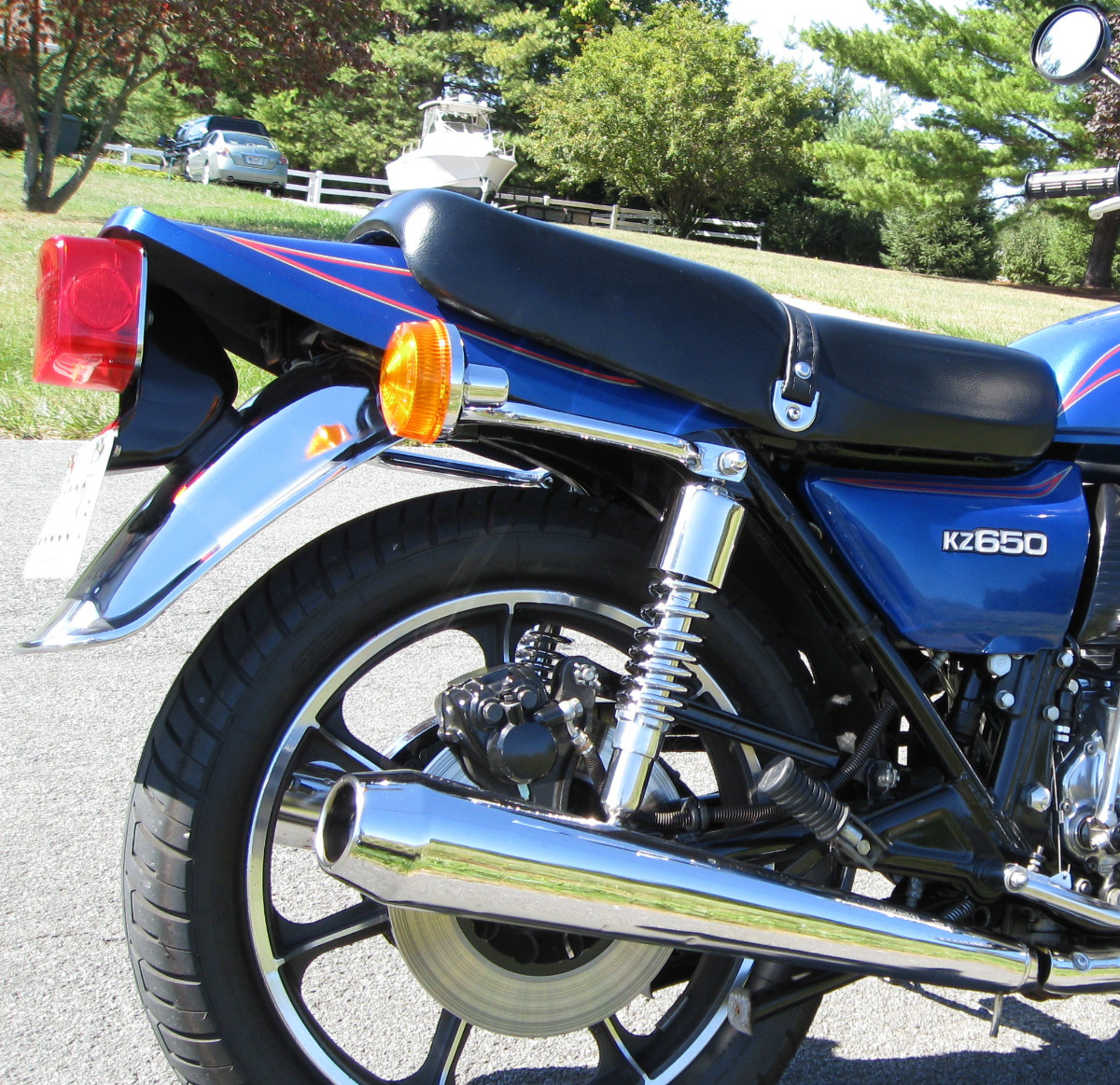

If you're considering staying close to stock consider Hagon shocks for the rear. Contact Dave Quinn (see link) and he will set up a pair for your specific bike, riding style, weight, etc. I put a set on my bike 6 years ago and they are still great! I'm about 200 and my wife weighs only a little less than your, and these shocks have never bottomed. Along with providing superior suspension they have stainless steel bodies and shrouds. Mine are like #4 in bottom picture. Ed
