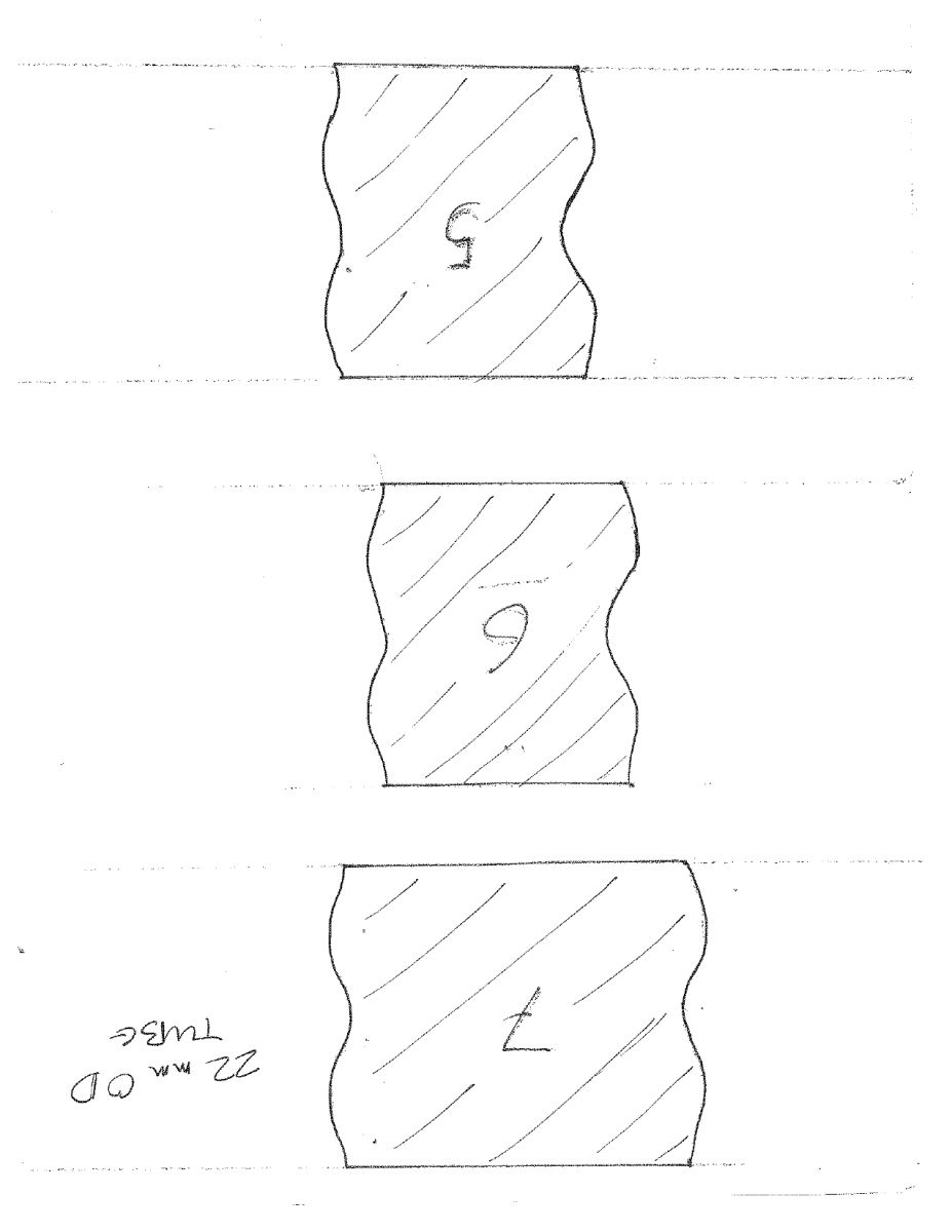

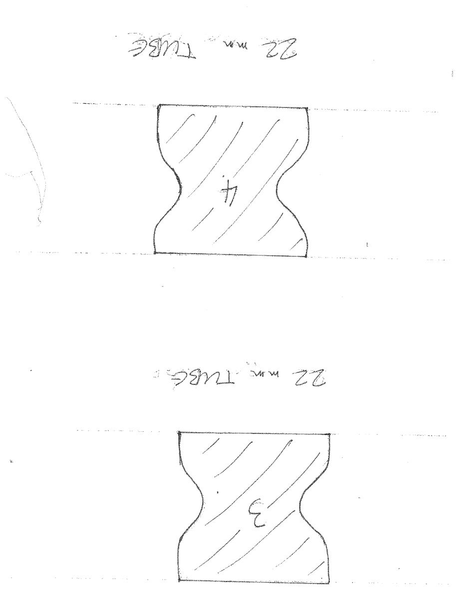

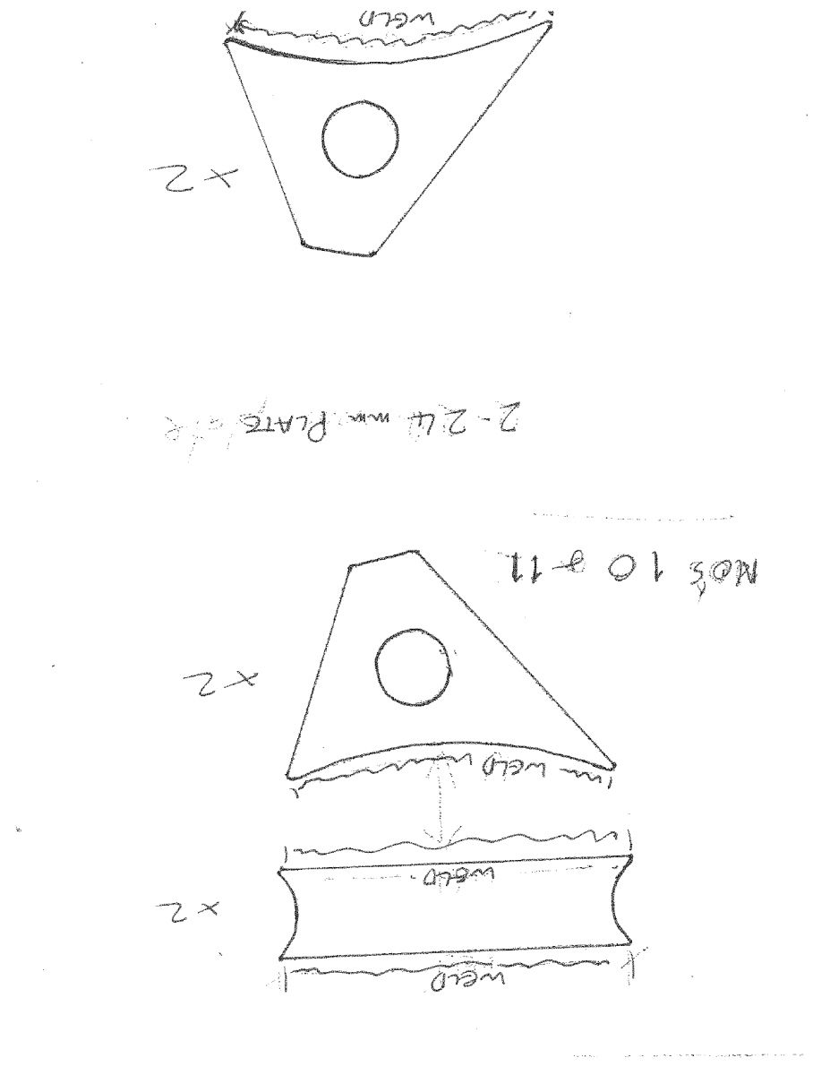

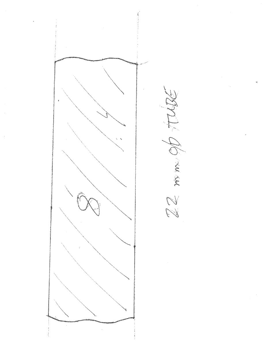

"FREE" PMC frame brace templates!!!!!
- Posts: 7444
Re: "FREE" PMC frame brace templates!!!!!
07 Jan 2013 23:32

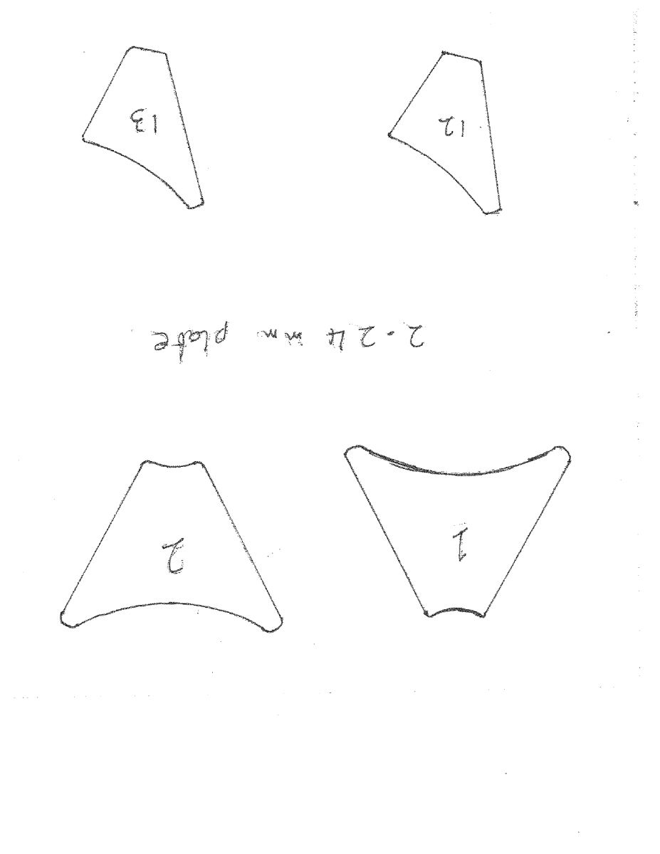

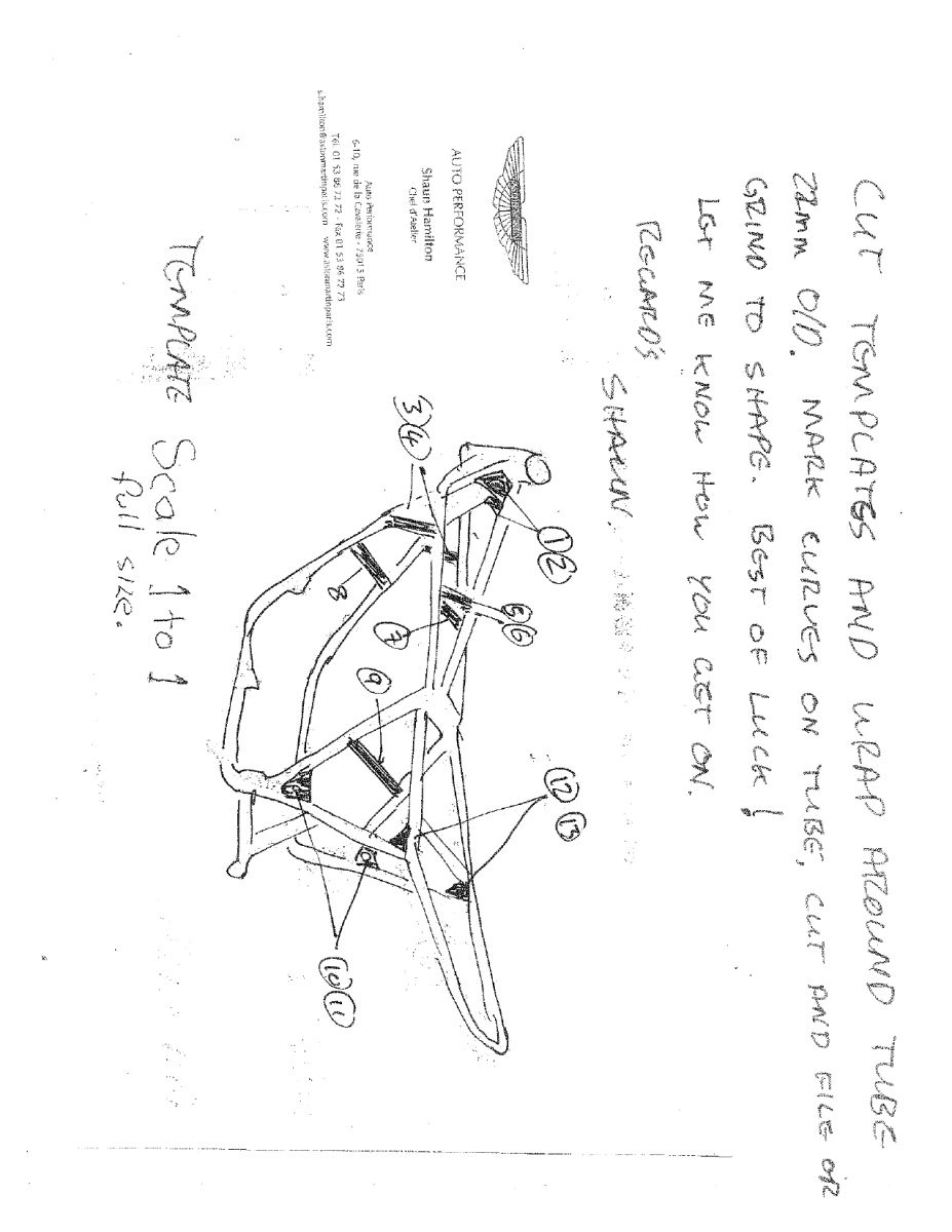

for some reason we can't post pdf files to the forum.
you can put them in the filebase tho.
i have converted them to jpg but i think they may not be to scale.

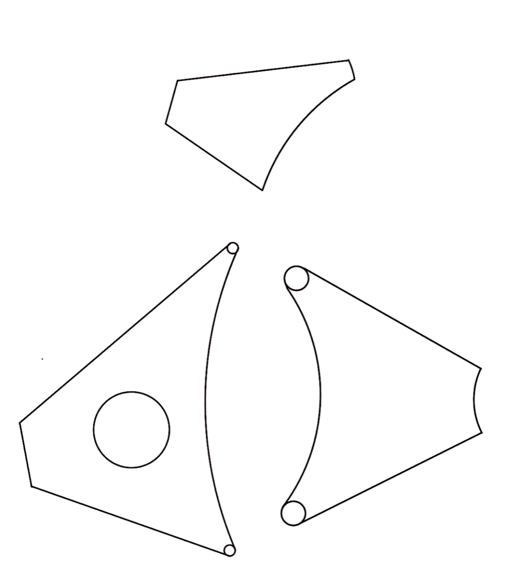

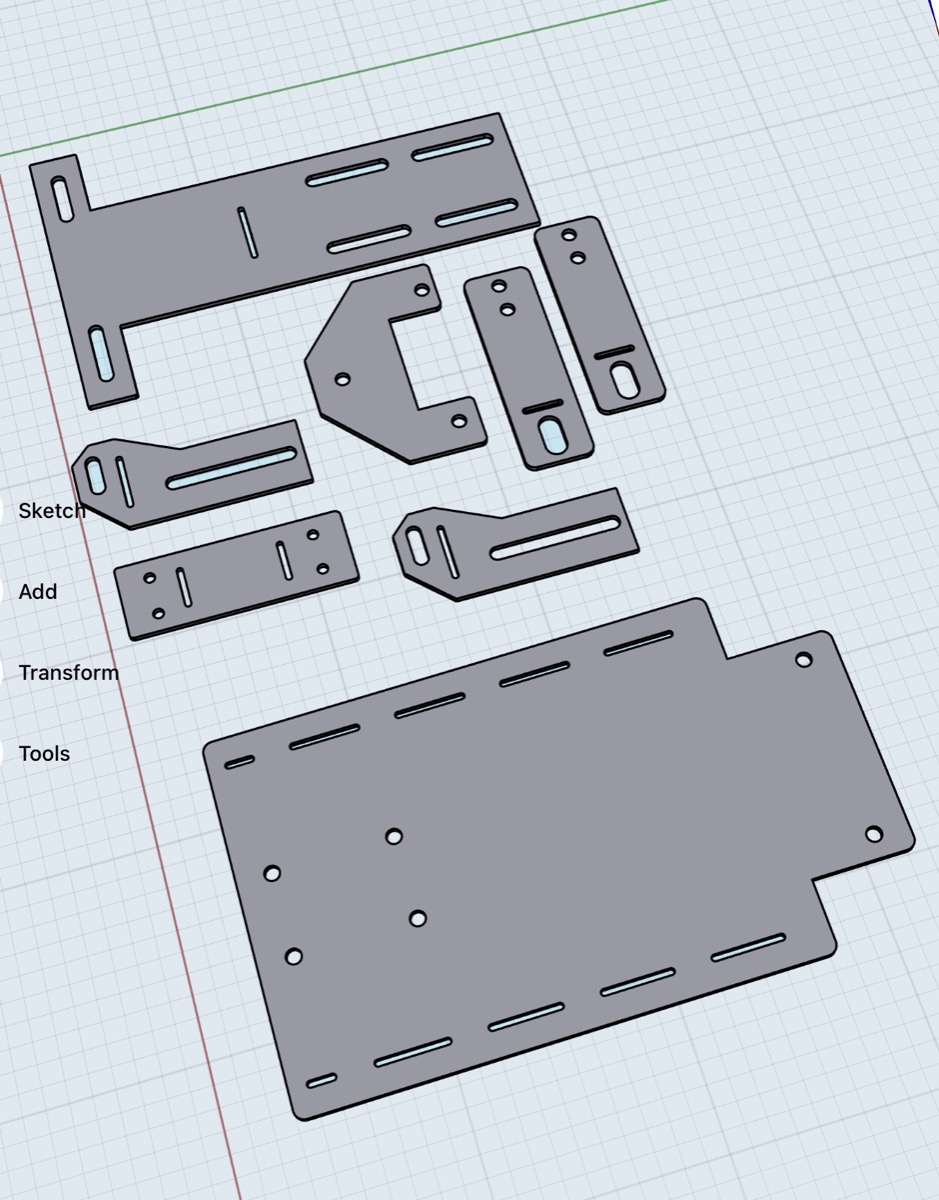

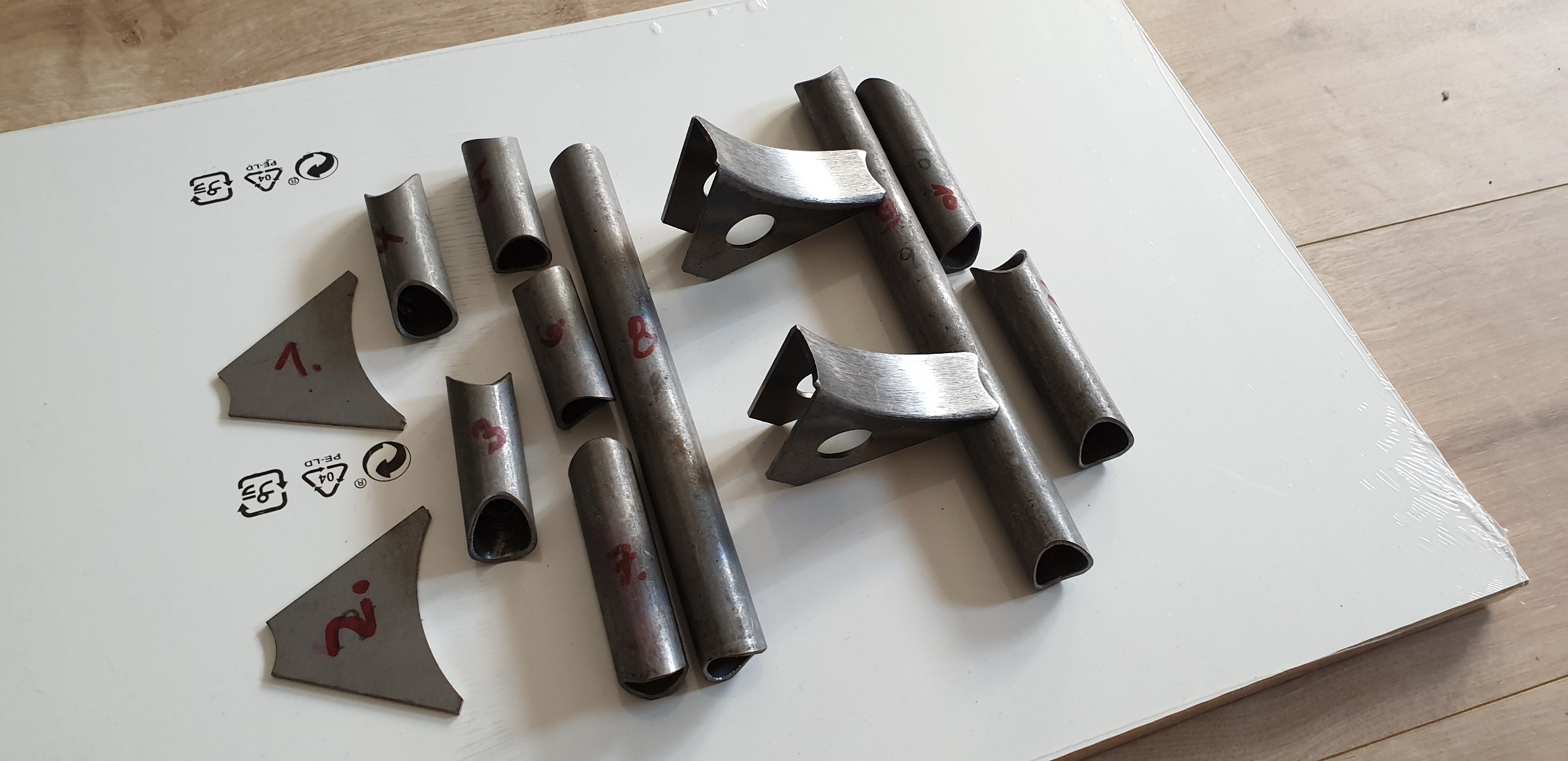

If any one interested in the 6 plate steel parts of the bracing kit I can draw them up ready for laser cutting for next week.

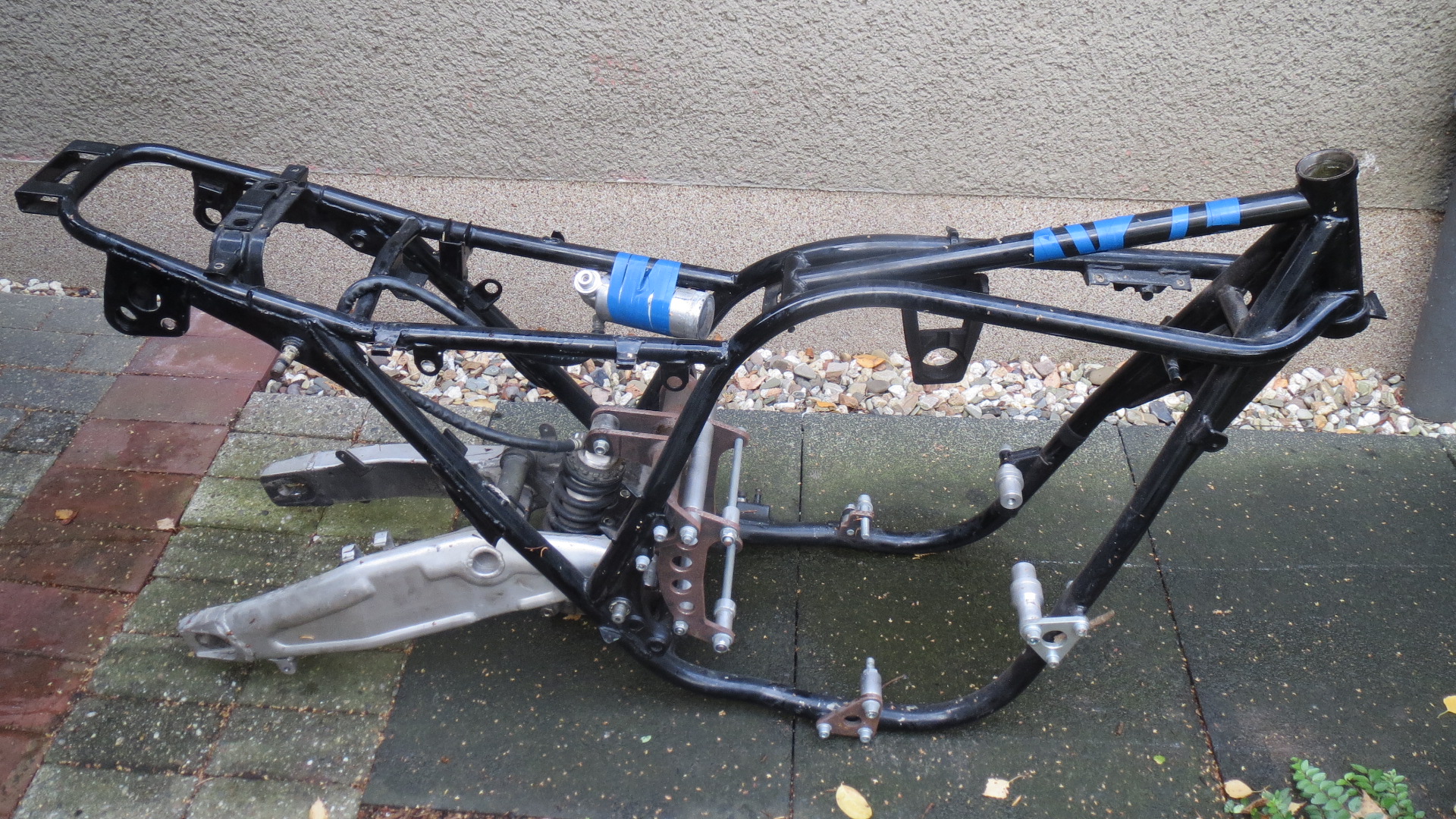

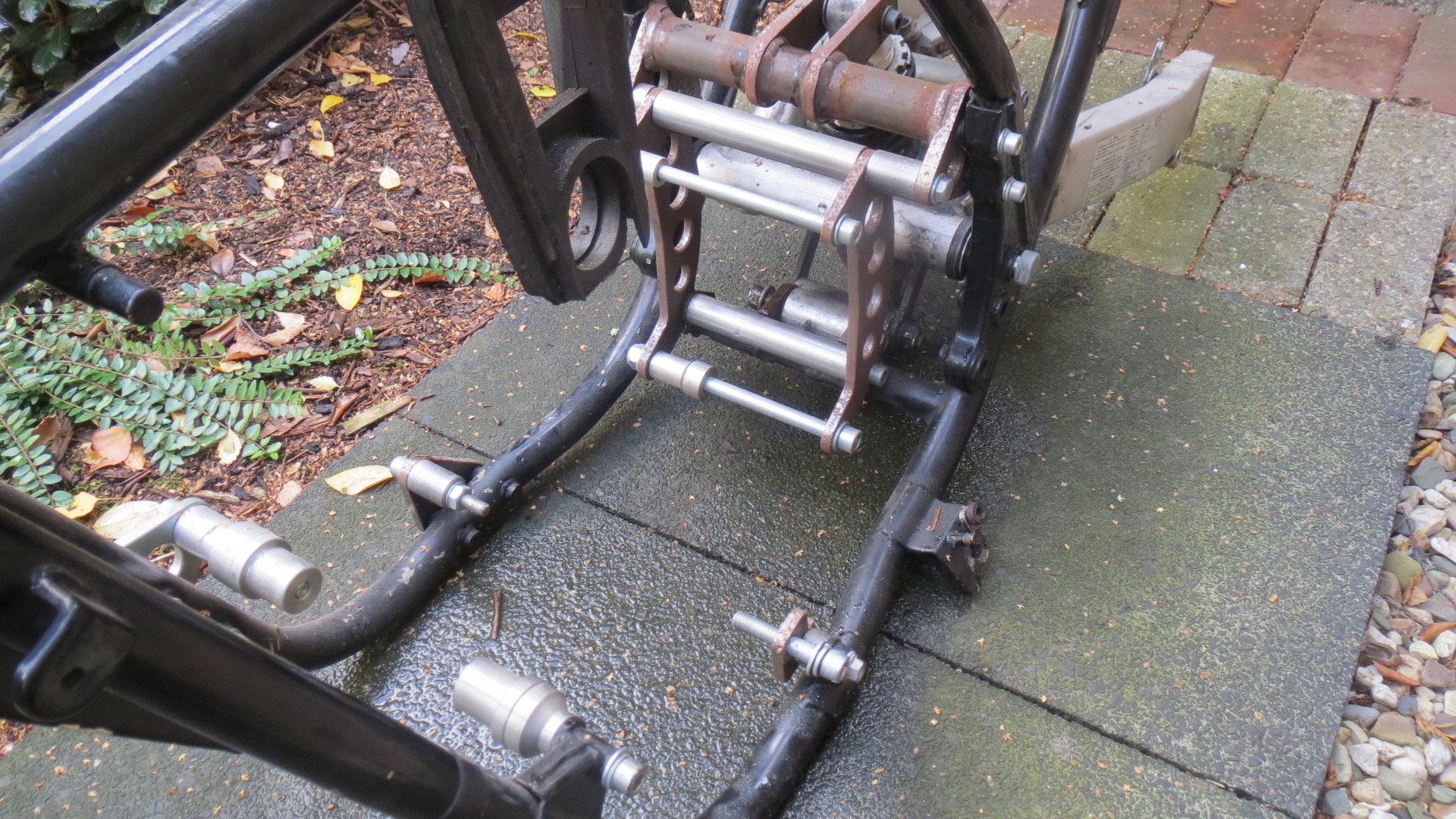

Frame bracing is something that I REALLY want to do... but I think it's probably a terrible idea to do to a titled Z1 frame. Granted, I have no intention to ever sell the bike, but I like to keep all my modifications reversible.
Someone convince me to do it.

09 Sep 2021 13:52 - 09 Sep 2021 13:53You don't want to do that, keep it stock.Frame bracing is something that I REALLY want to do... but I think it's probably a terrible idea to do to a titled Z1 frame. Granted, I have no intention to ever sell the bike, but I like to keep all my modifications reversible.
Buy a second bike if you want to go "nuts" with modifications.

09 Sep 2021 14:15Scirocco post=855073I am missing part# 12, 13 in my set, get it as a bycatch to the GSXR engine frame mount and mono shock bolt on conversion kit.
Im doing up a set for myself so ill cut the extra 2 and send them over to you. As for those in the states ill draw the flat stock up in 3D and post it on file share for anyone who can get it to laser cutter.

No problem bracing a Z1, I plan to do mine (one owner) over the winter. However, Im not using all those parts, dont think they are all needed. Im basically just trying to get the seat/tank flex out.

Just finished drawing up the under tidy kit for the Z1, kz900 and kz1000 not sure if it fits any of the other models, I’m goin to cut these for myself first and if everything lines up I’ll put file on file share for those who might want it.
