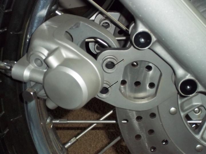

Hello. Rebuilding front calipers and Z1 sent a baggie with four o rings. Don't know where these go and kawasaki.com doesn't show them in the parts diagram. Anyone know where these go? Maybe they are not used on my 79 shaft.....

On my kz1000 they went in the caliper where the mounting bolt goes though....there will be a grove they go into in the bolt hole.

Yes in the bracket. Remember some caliper grease. JMO
Heres a pic.

Awesome thanks!
