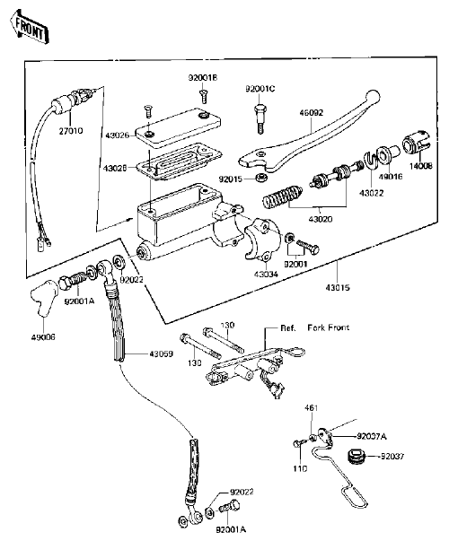

If needed, may use the link in my signature for help with navigating kawasaki.com to access the diagram listed as Front Master Cylinder in the component listing.

Yes, I have that diagram in a factory service manual, I guess there is some corrosion in there, I guess I'll just have to pull harder lol. it's definatly stuck and doesn't want to come out.
