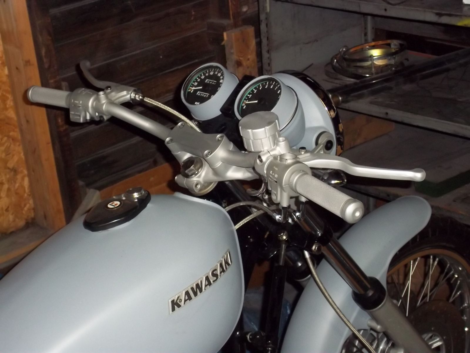

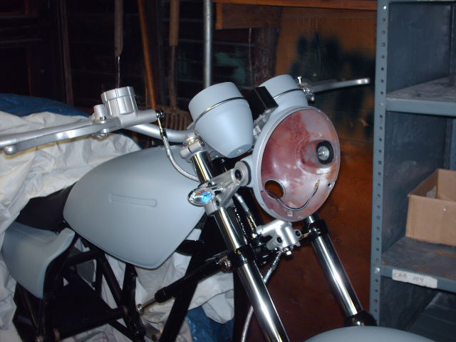

That set up is LTD. I cut up some stock parts, milled, drilled, filed down
then welded the aluminum together. This one won't have any rubber mounts for vibration.
But then it won't be driven very far anyway with struts. It's just a parking lot bike in
the summer, if anyone ever finishes it.
Get yourself some different bucket ears so you can drop the light bucket down too.
I love the looks. You got to just start and do it!

Z1KZONLY, what are those fork ears from? Thanks
