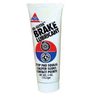

Re: ---->>>>Sil-Glyde Brake Lubricant brakesz zbrakesZ
04 Oct 2012 12:46 - 22 Feb 2013 10:22
Permatex ultra disk brake lubricant in the small packets. It doesn't take much, so a pkg of 2 will last quite a while.
Motor Head's recommendation (see below).
