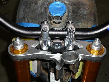

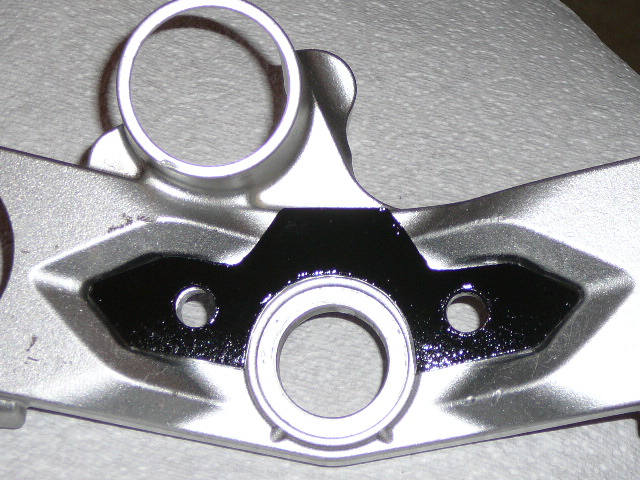

NOTE: Most of the ZX6 upper trees are designed for clip ons where you'll require risers for bar mounts unless going the clip on route. The upper trees don't sit flat on some of the model years such as mine where I had to use flat plate spacer...

I found a zx6 swap thread on Kawasaki forums.Looks like from 98 to 08 zx6 triples will work from zx6 to zx6.You may have to make some stem mods though.I already have to modify mine to fit the kz.It looks like the 00-02 upper triple is flat,so it may be easier to install the bar risers.Thanks for the info omr.
