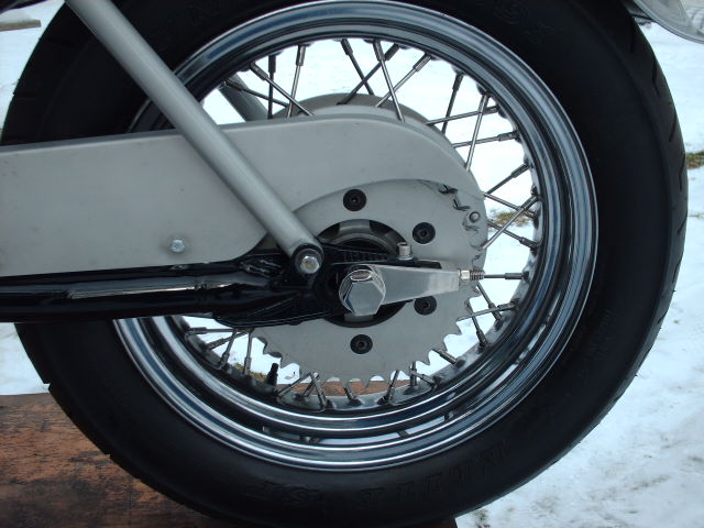

04 Aug 2012 15:49Factory modified's are nice, the suzuki GS swingarm is nice also. Easy swap.
Do you have any machinist, welder friends?
Build one from old parts.
I like this stock set up. this is a 150x60x16 hog wheel. could take a 160.
