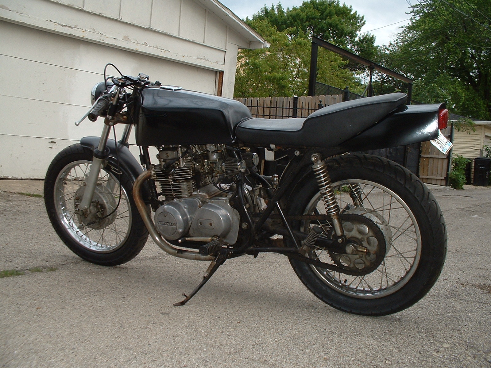

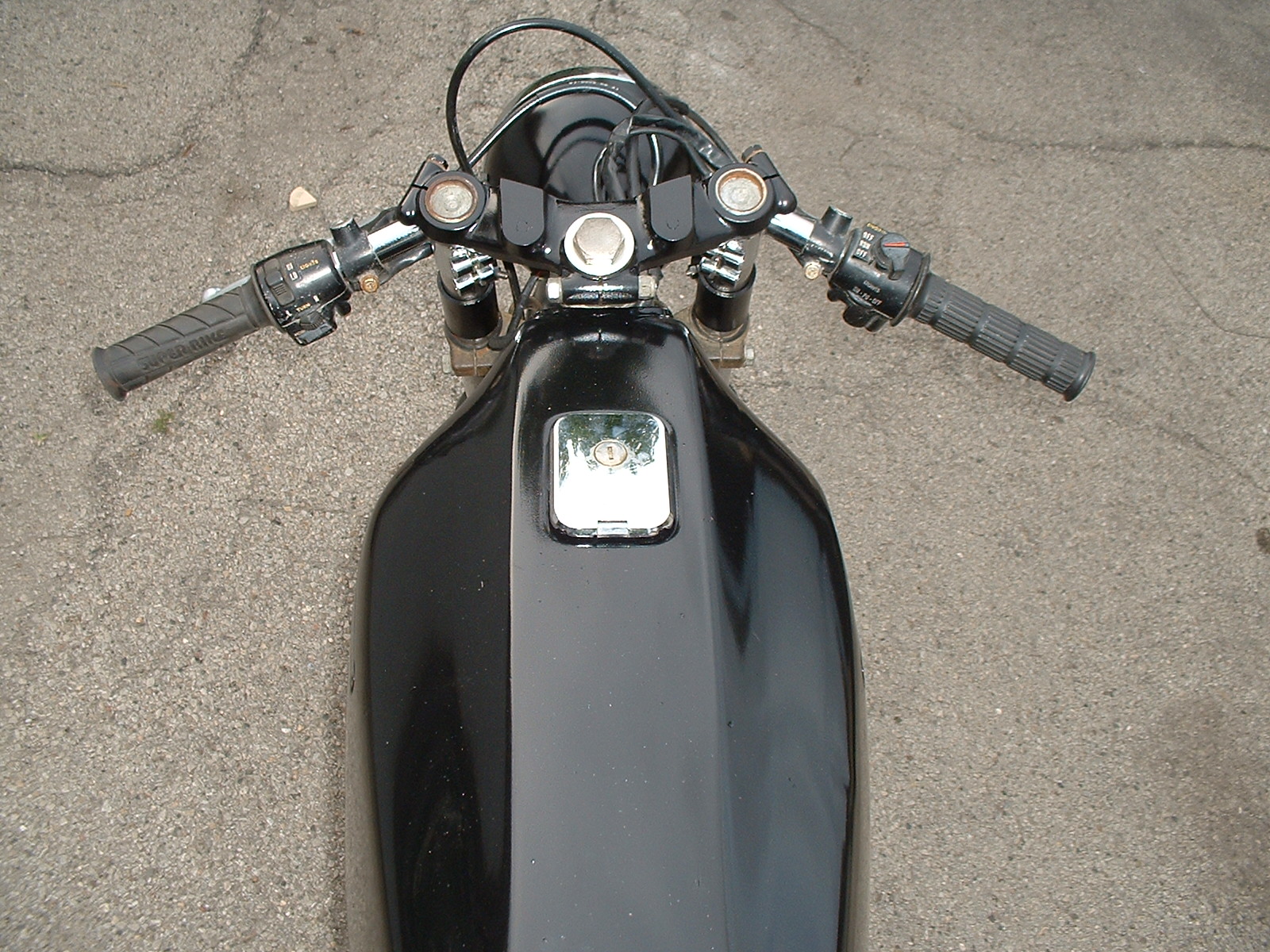

26 Jul 2012 19:41 - 27 Jul 2012 11:52 #538849 by loudhvx
Replied by loudhvx on topic Clip-Ons or Cafe Bar?
I tightened in some stainless bolts into the holes so the holes would be filled after I cut the bar holders off and then sanded the whole works down on a simple belt sander.
This was on my buddy's bike.

26 Jul 2012 20:03 #538851 by esion
Replied by esion on topic Clip-Ons or Cafe Bar?
WTH!? No gauges? Thats just asking for a ticket.
