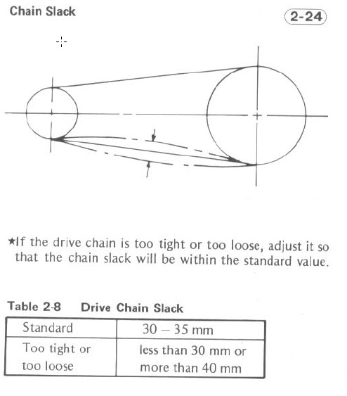

1/3rd" was to tight, and it needed to gain some slack. Hopefully it will settle in. Use a good lube on it.
From the FSM, 81-83 1000

Yeah I know it was too tight to begin with. I was informed to put it all the way to the front of the adjustment and cut chain to length. If I would have went an extra link it would already been back quite a bit. Oh well, I think it just needed to settle into the new sprockets and whatnot.
