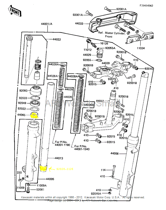

Well it was high time I did the front forks on my 82 K2, as it has over 40K miles now. I rounded up some oil, seals, then went to get the bushings. Well as many have found the diagram only shows the outer, 44065, not the inner, which goes on the end of the Tube, 44013.
44065-1091 ! BUSHING-FRONT FORK,OUTER TUBE That"s easy
But what about the inner?
Well I looked around at the different bikes from the same period which came with a 38mm fork, and found that the 92028-1126 BUSHING, FORK PIPE From these models is a perfect replacement part.

So if you're looking at your parts diagram and thinking, where the "F" is the listing for the Inner Bushing? Try these, for your 38mm forks.

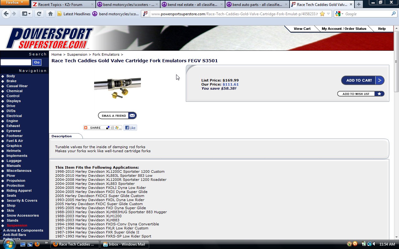

These are the correct Race Tech Emulators to fit inside the 38mm forks. On sale here:
www.powersportsuperstore.com/Race-Tech-C...8233.htm?Click=35177
