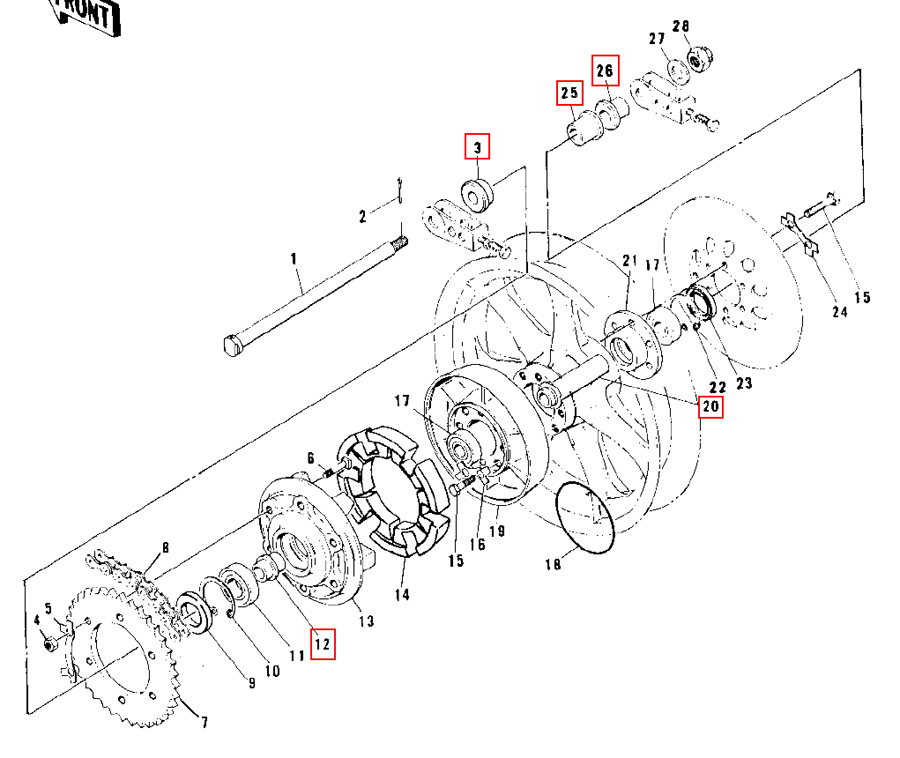

06 Jul 2012 16:39 - 06 Jul 2012 16:55pauleaston wrote: I tried tightening the castle nut, but it just tightened up the wheel bearings and the wheel wont spin.
If assembled correctly that should not be physically possible - something is definitely assembled wrong or missing.
Here's a diagram of your rear hub assembly, what you should pay special attention to are the spacers (the parts I marked in red): #3, #12, #20, #25 and #26. Obviously also check the condition of the bearings.
#3 goes between the left side adjuster and the sprocket hub (outside of bearing #11).
#12 goes between the sprocket hub and the wheel (inside of bearing #11 and outside of left bearing #17).
#20 sits inside the hub between left and right bearings #17.
#25 goes between the right bearing #17 and the caliper bracket.
#26 goes between the caliper bracket and the right side adjuster.
Check that all spacers are present and have the correct thickness - they should only touch the inner bearing races, even with the castle nut tightened to the max the wheel should spin freely, provided the bearings are good.
Btw, just a thought, also make sure that the binding isn't the caliper mount moving in when tightening, locking up the rear brake.
Hope this helps you some, a stuck rear wheel at any speed is no fun.

See if part #20 is there the axle spacer that goes inside the wheel between the bearings. I think you could possably be missing a bearing or it came out without the inner spacer. In any case park it & fix it before it dumps you on your rear. If you tell me whats missing I may have it, Ill sure take a look for you.

#12 and #20 are the spacer's that locate
the #17 bearing as it's a floating bearing.
With out #12 or #20 when you tighten the axle
and bottom the bearing you then start to pull the inner race
in till the bearing's trash.
