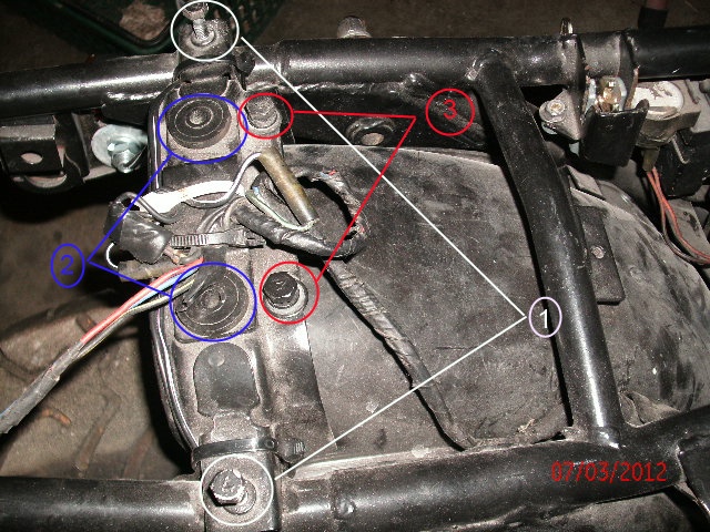

04 Jul 2012 01:11I know that bolts (1) are for the rear duck tale. And I think that (2) is to hold the mud shield/fender to the frame. What are number (3) for?

rear chrome fender mounts

Arent #1 for the helmet hooks?

#1: Tail piece
#2: Chrome rear fender
#3: Plastic inner fender

Looks like someone added a couple hole to fit a different inner fender.

what he said
OnkelB wrote: #1: Tail piece

How about
#1 Ducktail/ Helmet hooks
#2 Chrome fender/ Plastic fender
#3 2 Hooks to hold wiring in place
