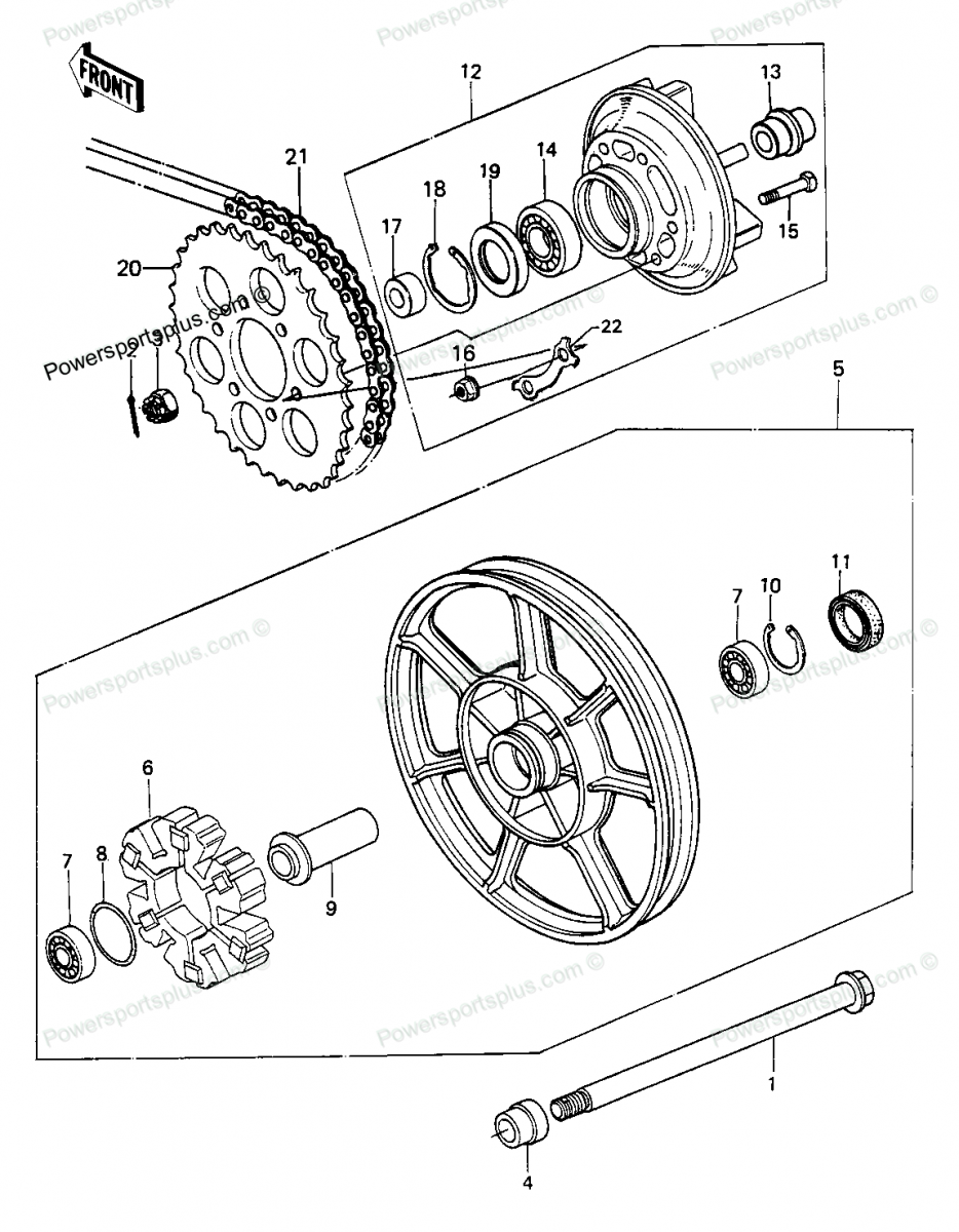

Re: 1980 Kz750E Rear wheel too tight?
02 Jul 2012 14:04 - 02 Jul 2012 14:05
You can put it in from any side. You probably have a spacer in wrong at the rear hub.

- peter1958
- Posts: 1553
- Thanks: 198
02 Jul 2012 14:21
www.kzzone.com/

- Deputy723
- Posts: 12
03 Jul 2012 15:26
Thanks everyone for the help...and thanks Peter1958 for the diagram. It showed me that I had one of the collars in wrong. I reassembled it and its perfect!
