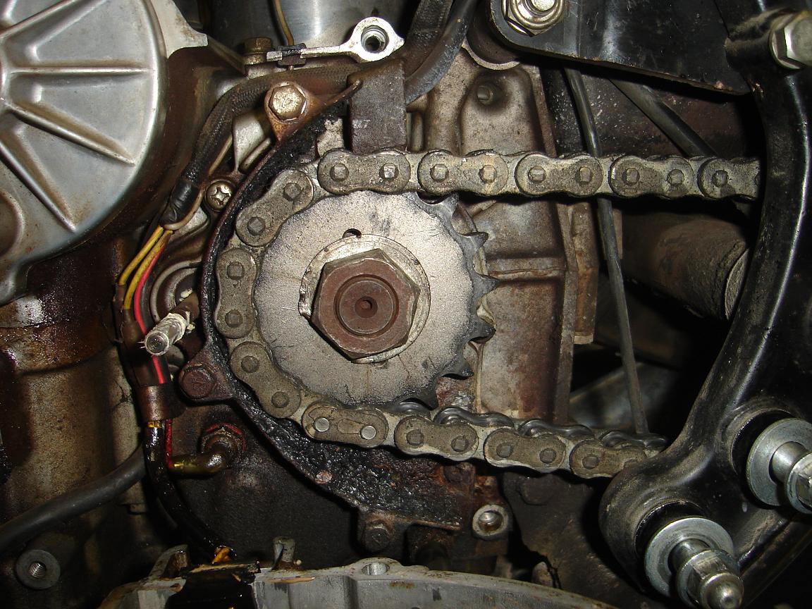

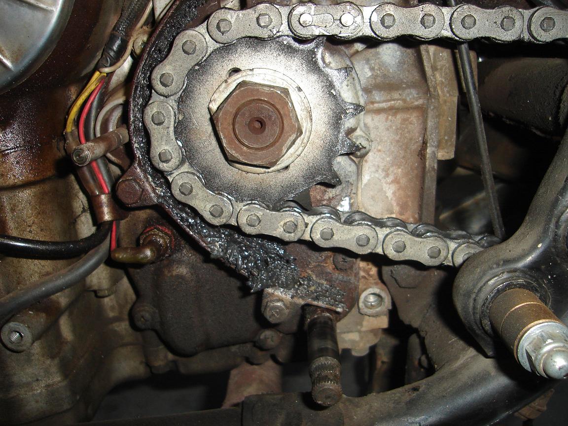

I need a little sprocket education. I'm replacing the front sprocket on my 1979 KZ750. The stock sprocket has a hole in it for a tab on the sprocket lock washer to fit in.
I'm looking at pics and diagrams of sprockets advertised as fitting this bike and a lot of them don't seem to have the hole. The JT/Emgo sprocket sold by Z1 (and other retailers) for example.
Then there the sunstar sprocket which does appear to have the hole.
Am I wrong about the JT/Emgo? Does it have the hole, they just don't show it in the diagram? They are all over the place at lots of retails and advertised as fitting my bike. I just want to be sure. Anybody used one of these before?

TBH you dont need the hole, the lock washer is enough on a modern ZX10R Ninja to stop it coming off so the twin will be fine!! Iys a kind of braces AND belt scenario. I'm also running 520 speockets & chain. Again, if they'll cope with a well ridden ZX10's power they'll do my Twin fine!
PS - The lock washer im talking of is off a modern Kawasaki, they fit fine & are cheap. My 07 ZX6R race bike uses them. Just install, tighten the sprocket nut & then bend the edge of the lock washer over the sprocket nut so it cant move

As 750steve said, the hole does not serve any purpose in this application. On my 1982 KZ650, there is a washer under the nut, and it has teeth on the inside diameter that fit the splines on the shaft, thereby keeping the washer from turning on the shaft. After installing and torqueing the nut, you bend the outside lip of the washer over one of the 6 faces on the nut. This keeps the nut from ever unscrewing.

The hole is needed only if you have the original (obsolete) type of lockwasher which had a tang that fit into the hole. Most washers don't, they just bend over a flap of metal against the flat side of the nut. Chances are you don't need the sprocket with the hole.

Topper, tab on nut flat is sufficient, going on 4 years no problems
16 tooth (original size)
17 tooth (+1) about 500 RPM drop at 65 mph
18T (+2) requires guard removal

04 Jul 2012 12:36damarble wrote: Topper, may I ask why you are replacing the 18t?
Here's why: kzrider.com/forum/5-chassis/529642-sproc...fe-expectancy#530060
With an 18T sprocket even the slightest amount of chain slack allowed the chain to rub against the clutch push rod and transmission cover.
