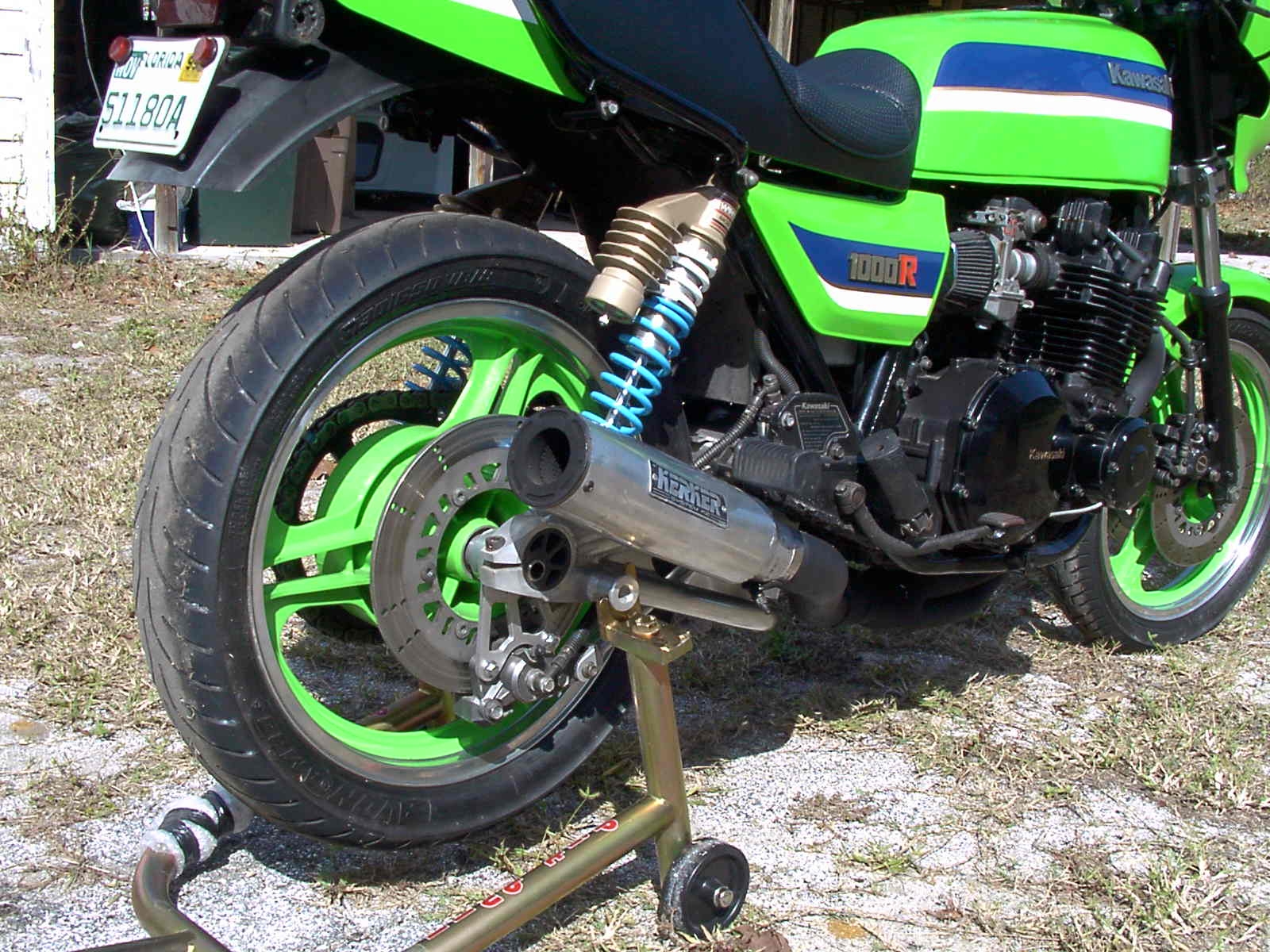

24 Jun 2012 22:35Oppinions will vary, but on my kz1000r I put a 3" lower tripple, like the s1. No old 80's road race kaws used a brace that I have found, and the large surface of my lower really helped.just my .02.ty.steve
