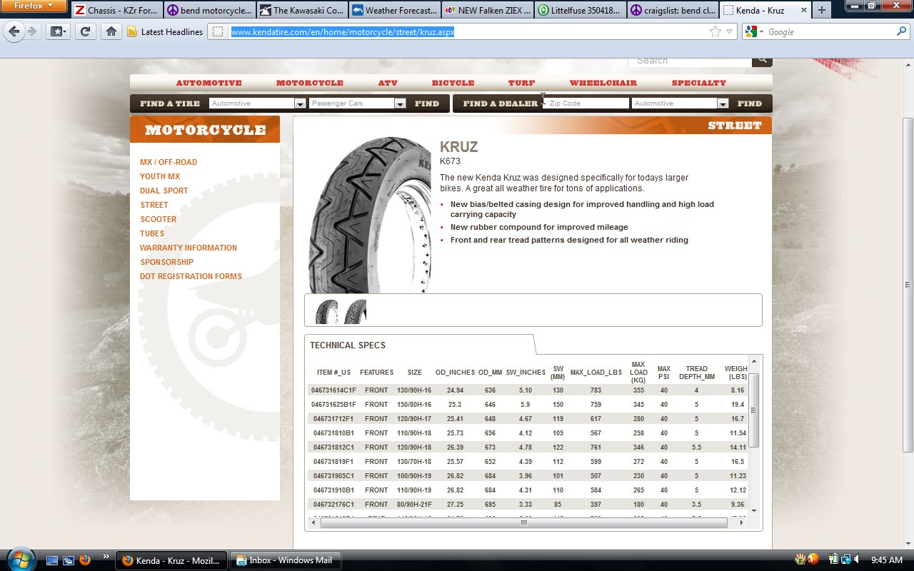

Maybe consider a different Kenda, so it would be closer to your new rear. Maybe this one, in the proper size front. I've had 4500mi on mine, and have just ordered a new front tire. Not another Kenda this time, although I've had no issues with it. Just trying something else on the front, and rear.
www.kendatire.com/en/home/motorcycle/street/kruz.aspx
