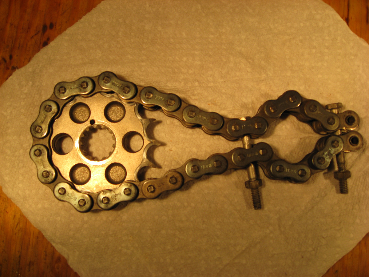

Looked over the procedure for changing the front sprocket. The manual mentions a special tool called a sprocket holder. Do I really need that or is there another way to keep the sprocket steady? I'm thinking there's gotta be a way to put this old chain to use in this job.

I use the old chain to hold the sprocket. If the chain and wheel are still in place, have somebody hold the brake while you break loose the nut. If not, wrap the chain around the sprocket and swingarm and use someting to clamp the chain toghether right behind the swingarm pivot - a bolt through the links, for instance. Now breaking the nut is easy.

18 Jun 2012 18:13 - 18 Jun 2012 18:14Topper wrote: Looked over the procedure for changing the front sprocket. The manual mentions a special tool called a sprocket holder. Do I really need that or is there another way to keep the sprocket steady? I'm thinking there's gotta be a way to put this old chain to use in this job.
Also, this may seem silly, but can I just pull the clutch push rod out and stick a new one in? The manual is kind of mum on this and I just want to be sure there's nothing attached to the other end that's gonna come undone when I pull it out.
Here's cheap Ed's good ole sprocket holder. Just loop a section of chain around the front sprocket, pass one end of the chain above the swingarm pivot toward the rear and the other end below the swingarm pivot toward the rear. Connect the top and bottom chain lengths using 2 long thin bolts - one in front and one behind the swingarm pivot. There you have it; you can then loosen the front sprocket nut. Doing it this way you don't need a second person to hold the brake and you put no stress on the brake system. Ed

Thanks guys. Ed's good ole sprocket holder looks like just the ticket.
