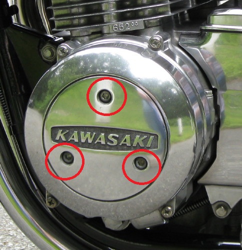

To see what model your bike started life as you may want to take a look at the VIN stamped into the frame up at the steering stem neck and compare it to Frame Numbers in the chart in the link below. If the VIN starts with KZ650B the bike started life as a standard model and would have originally had wire wheels. If it starts with KZ650C it would have been a “Custom” model and would have had cast alloy wheels (but not the rear one that’s on it now, and maybe not the front one). Also, take a look at the left side of the engine where you will see the generator cover. If the cover has 3 allen screws inside the circle (see pic below) it is a 1977 engine (unless someone went through the trouble to change the charging system). If it does not have those 3 screws it is a later engine. If you get a chance post several pictures of both sides of the bike. Ed
