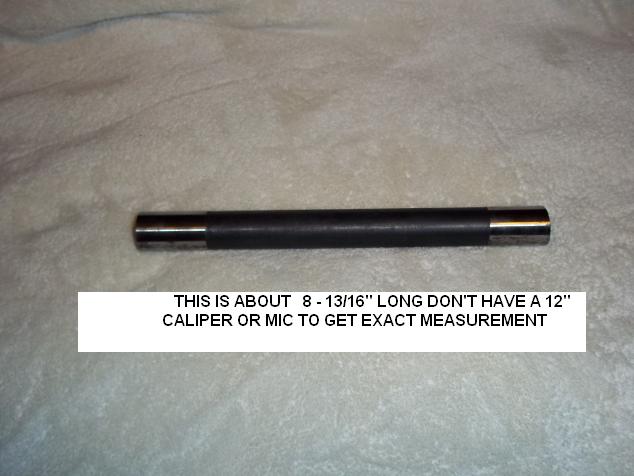

Had this in a parts box. Can't remember where it is from, It
is a Kaw though. This is 8 - 13/16" long.
