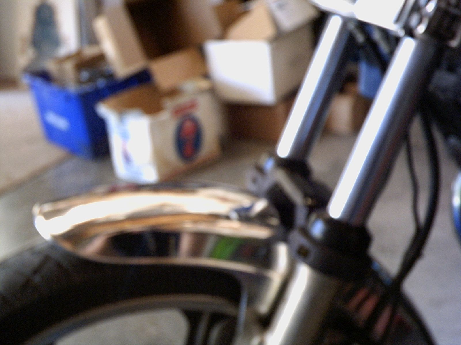

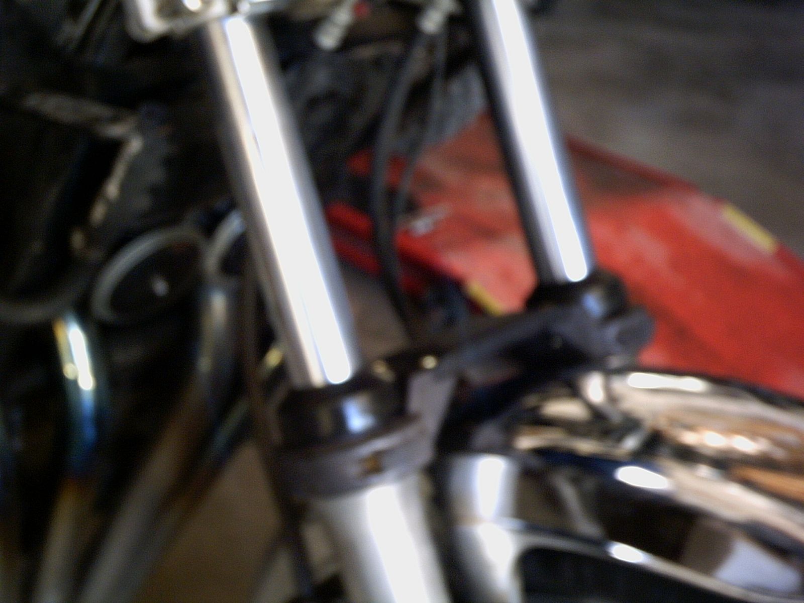

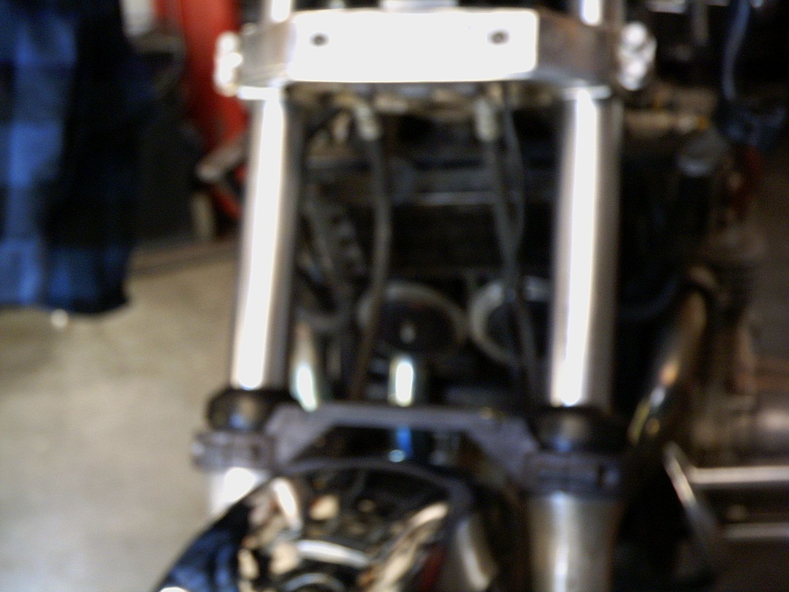

Bought this for brace from Fast From the Past, and it bolts right up in about 2 min with no issues.
Here is a page with all the dimensions: pmiusa.net/FFTP/fork%20brace%20dimensions.pdf
No ride yet, as I;m doing more this weekend to both the Kawasaki's. But just putting the front tire between my knees and grabbing the bars, there is 0 flex. It used to be a bunch of flex.
