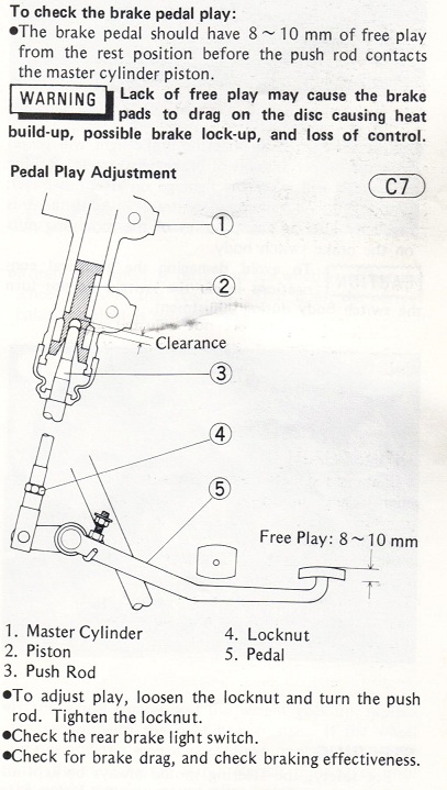

When fully cooled, would re-adjust the push rod from the brake pedal to the master cylinder, to allow more clearance before it contacts the master cylinder.
This means the pedal will be pressed marginally further before the m-c piston begins moving.
When adjusted too closely, the heated fluid expands to begin activating the m-c piston, whereby the brake locking gets progressively worse, until the disc becomes sizzling hot and locked tight.
If allowed to cool, the locked brake should release, but will again lock up, unless the push rod is adjusted to allow more slack.
