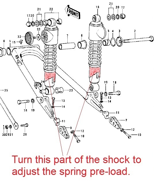

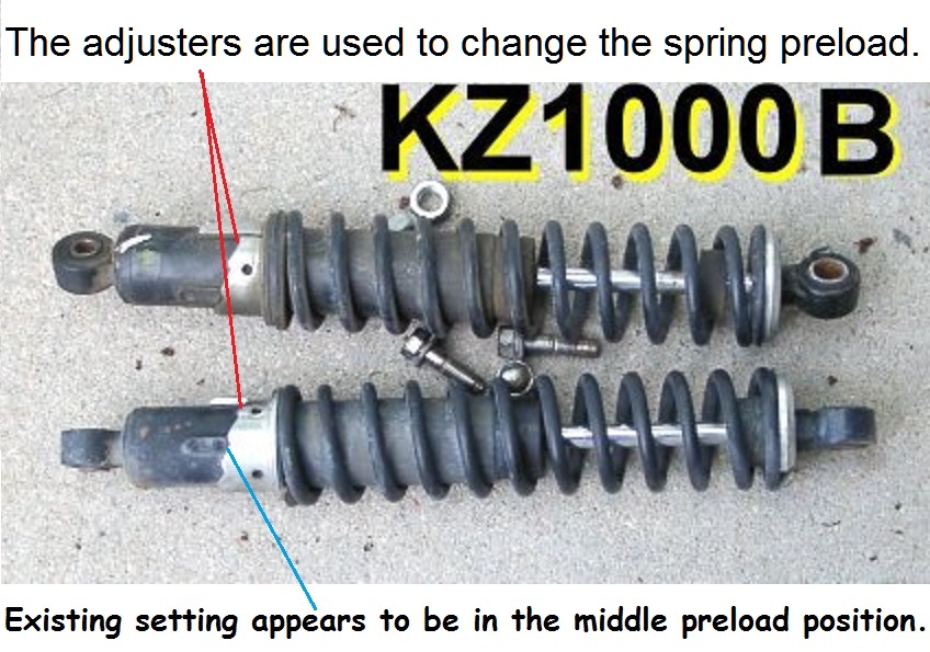

Increasing the shock pre-load might or might not relieve tire rubbing against inside of the rear fender.
Won't hurt to try.

I will try adjusting the preload to see if that will help. I'll have to find soemthing to turn it with because the spanner tool is long gone.
